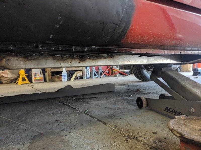

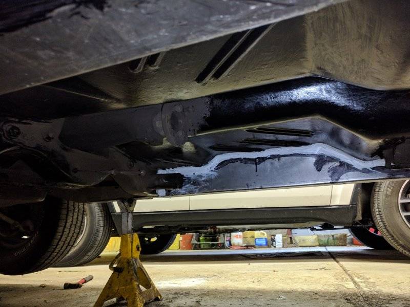

Got one subframe connector in... started fitting the drivers side yesterday but fell like **** so i didn't get far..
Haven't posted in awhile (like 3 people ever see this anyway) but got a tiny bit done.. both frame connectors are in, and the floor is ready for sound deadener..

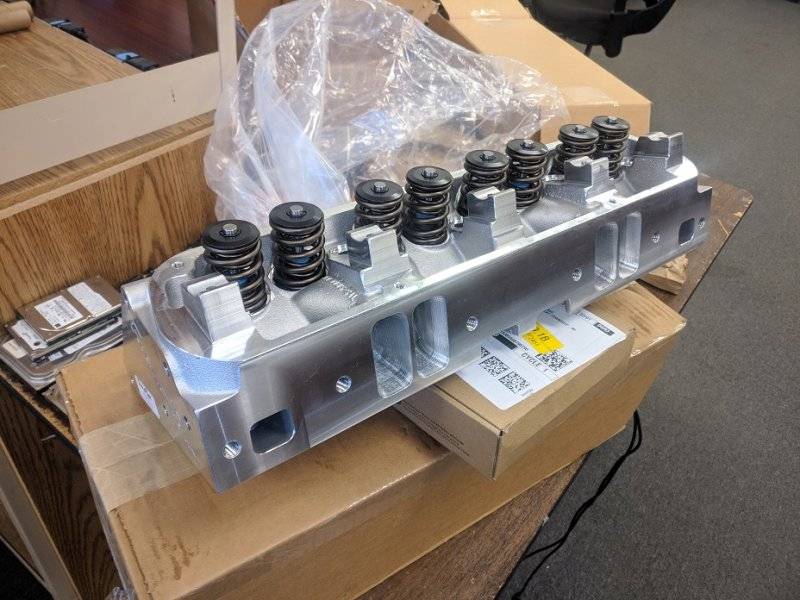

Parts for the 318 have been showing up.. so that's something. Still need to get the old poly out and rebuild the suspension and do the brake conversion..
Trickflow heads, Howards cam and a RPM intake... will make a happy 318 i hope :) Til i find a good 360 block to make a 426 :)

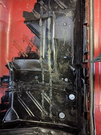

Got some deadener in last night... waiting on another box to show up, got cold again though.. so next warm day will be finish the floor and start taking apart the doors to clean the regulators and rustproof/clean
P.S. i'm a bit jealous of the other 62 clusters.. the belvedere one is not pretty :(
Seal sealer hiding the sins of my welder.... gotta let it set for a few days and then paint. Also my front window regulators grease was hard as a rock.. Bought some stuff called Purple Power at walmart.. $12 for 2.5 gallons, i have them soaking in it, checked on it after 30 mins and it was bubbling. hope it works. And i just realized that i probably left the little felt washers on it :(

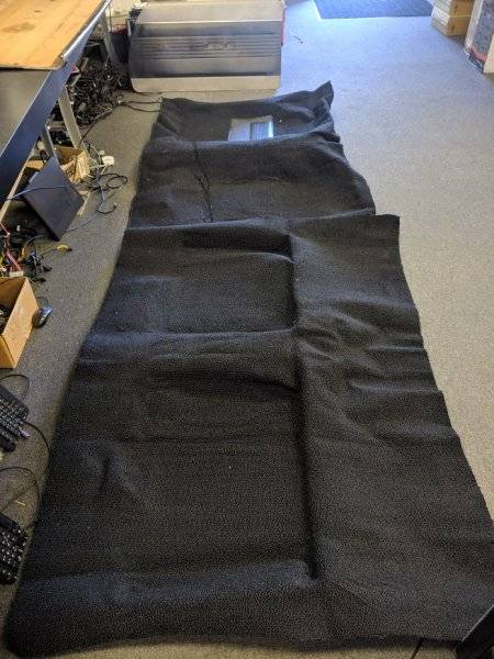

So.. new carpet showed up, actually looks good.. i didn't expect it to be molded to fit so that makes me happy :)
Set them out on a sunny day before installing. Removes wrinkles and creases.
