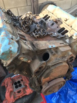

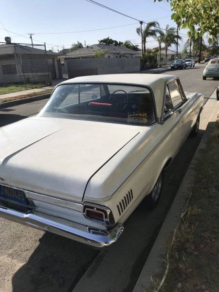

These guys are giving you good tips & WELCOME!
1. Run a 26" wide radiator
2. Yes, conversion motor mounts
3. will need new exhaust manifolds...headers? & I suggest dual exhaust for sure.
4. Stock 440 will be fine...maybe a small cam/lifter/springs + headers + 650-750 cfm carburetor
5. IF you have no bolts in the back of the rear end (8-3/4"), that will work GREAT
6. Likely need a slightly different length driveshaft.
