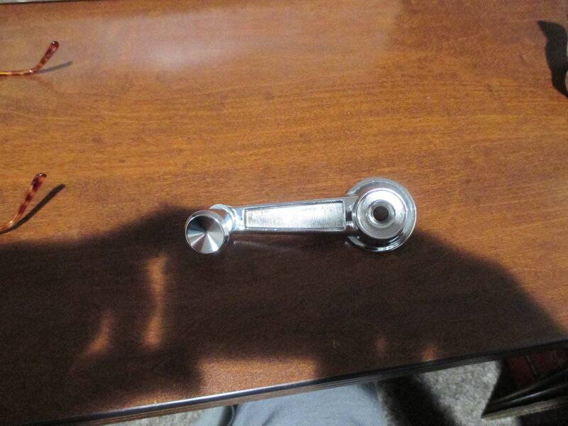

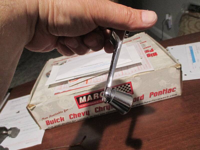

The crank on my driver's window is overall mint but the knob is floppy. I tried to peen the back to no avail so wondering what do you guys do to fix this??
Maybe I can bring it to my machinist to see if he has any ideas????

Only draw back to the repro cranks is that they are far nicer than the original castings. I would not waste time with the originals but you could try a Hydraulic press to tighten up the rivet.

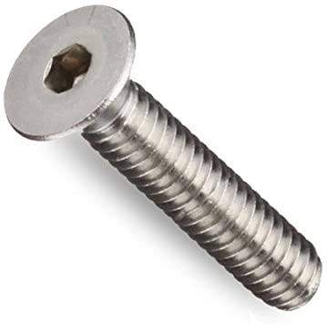

If you're really ambitious you can drill out the rivet, tap the knob and replace the rivet it with a hex screw. Years ago, before repos were available, that's what I did. After some adjustments to the length of the screw and a little loctite it worked fine. I have an extra handle I can send you if you'd like to give that a try an see if it works for you. That way you won't destroy your handle test fitting it.
