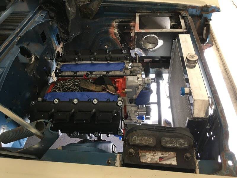

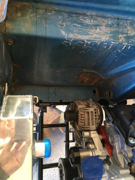

68 coronet hemi swap in Az

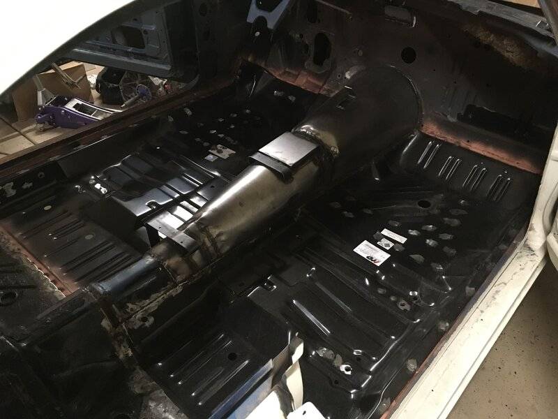

One side done just waiting for the driver side to come in

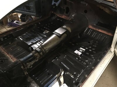

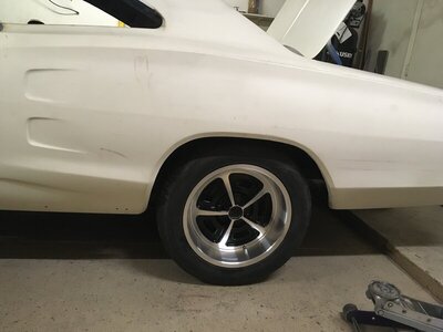

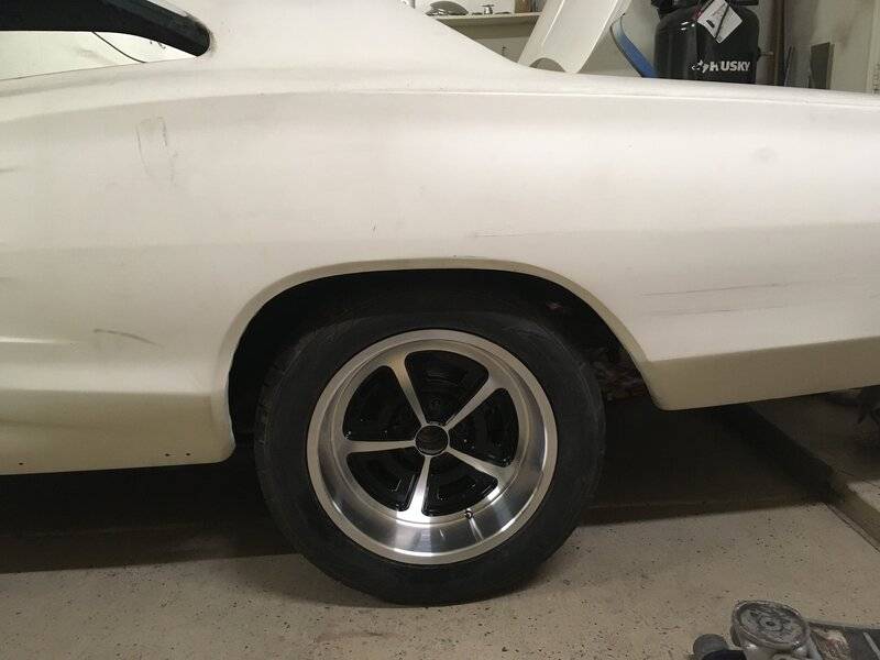

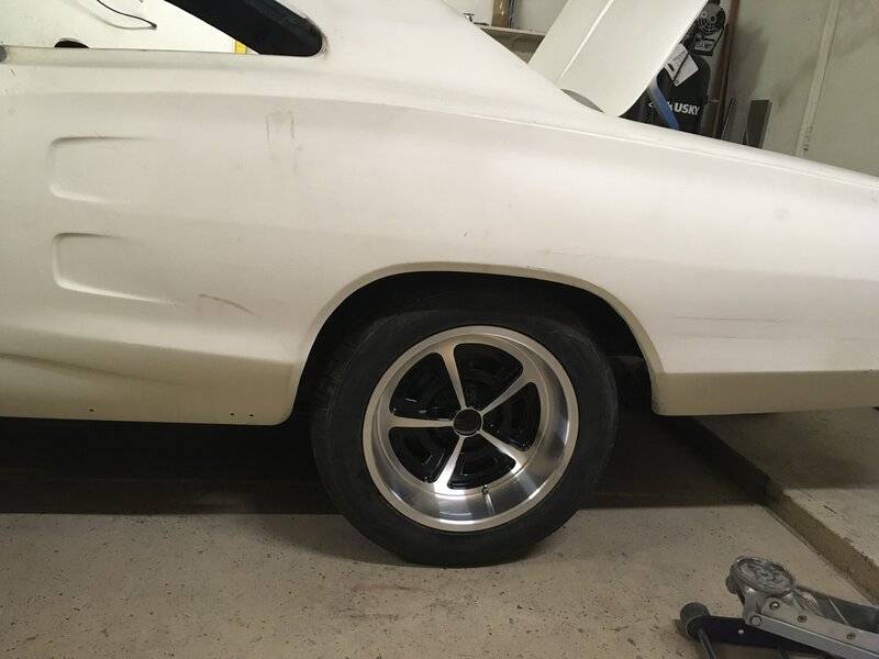

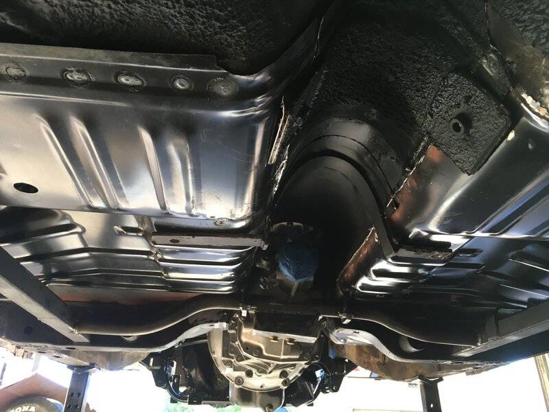

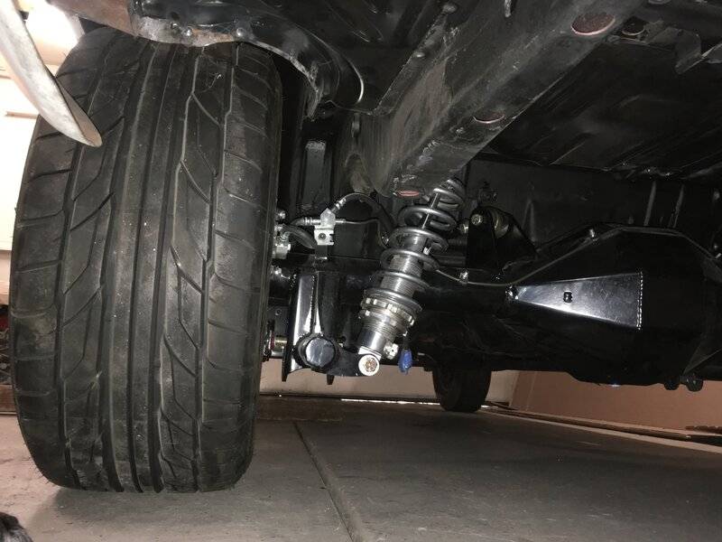

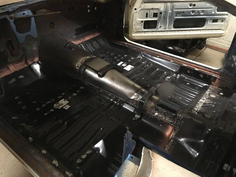

Got the drivers side floor pan in and test fit the wheel/tire I’ve had for a while now

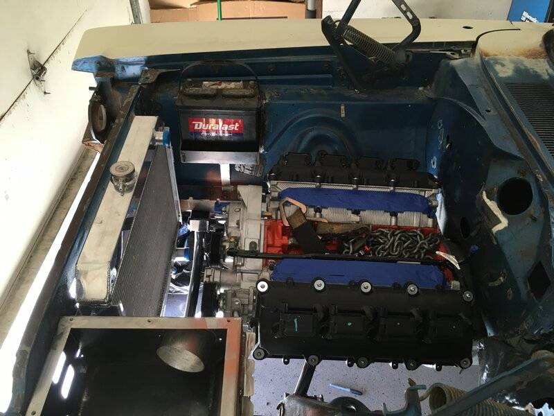

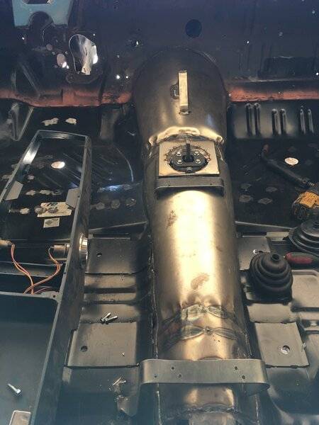

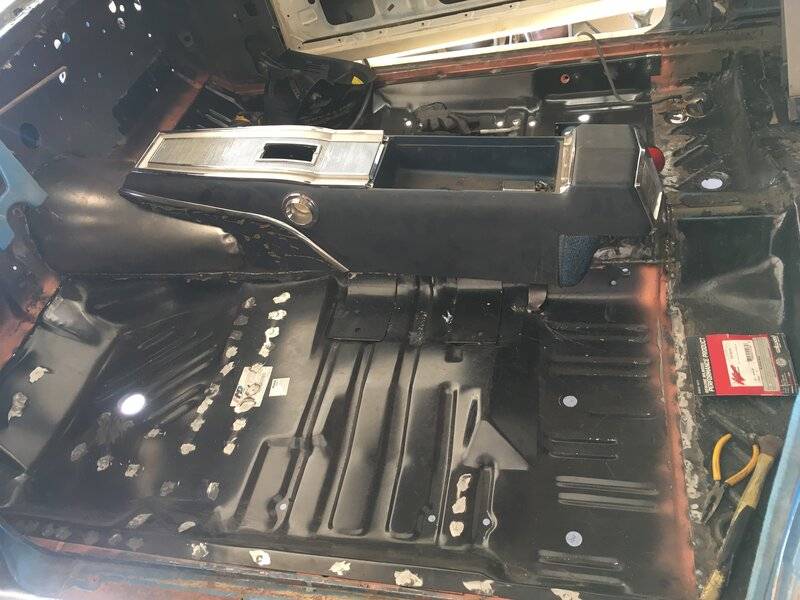

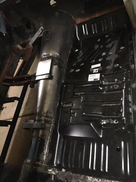

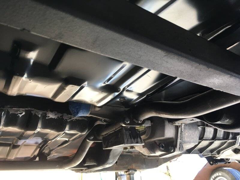

More progress . Got the tr6060 cross member done . I sold the mopar crate trans for an auto then went back to manual and the tr6060 was about 3” longer . Also made a battery tray
DD7EA05C-2CF7-465B-A456-67B6713DD7A6.jpeg B64319D1-7C6E-443D-AA7C-E534756F623E.jpeg B212F76F-A5D7-43B2-A03A-038BAF68AECE.jpeg 25A2A11D-613D-4BD6-BF72-74F93A9844C1.jpeg DBAFD3F4-4C69-4F8B-9057-6AFCE3672693.jpeg

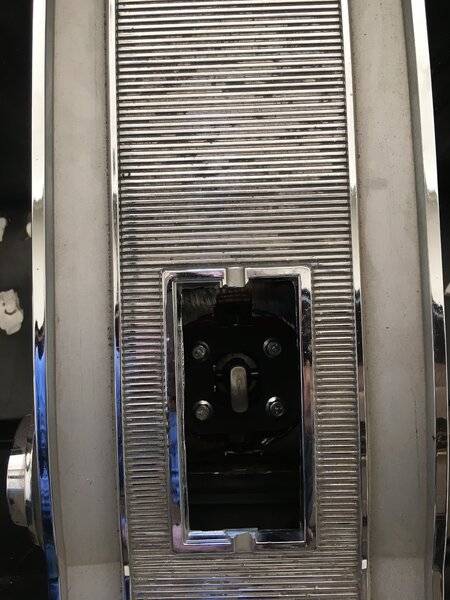

Looking good man! Funny I didn’t know your handle on Fbbo. We’ve talked on the FB forums. I have a console for my RR too. What are you going to do for the top plate/shifter opening?
i cut the center bar out so i should be able to have all the movement needed if not ill cut all the chrome trim out of the middle to see if I can match it up to the 4 speed top plate or ill just buy a 4 speed top plate lol
Nice work. Like where this is going to end up.
I’ve got my shifter in the furthest back position. So I don’t know about using any stock plates. Might have to fab one.
i just moved the console so the shifter is centered in the top plate , my shifter is in the rear position as well and the tr6060 shifter rear position sits further back than a t56 magnum
When you get a chance shoot me some pics of the ones you made.
That lines up nice. Are toying to have to radius the front at all due to your new tunnel? I’ll have to clearance mine some.
radius the console? mine sits up a little so its not actually touching , enough to get carpet under

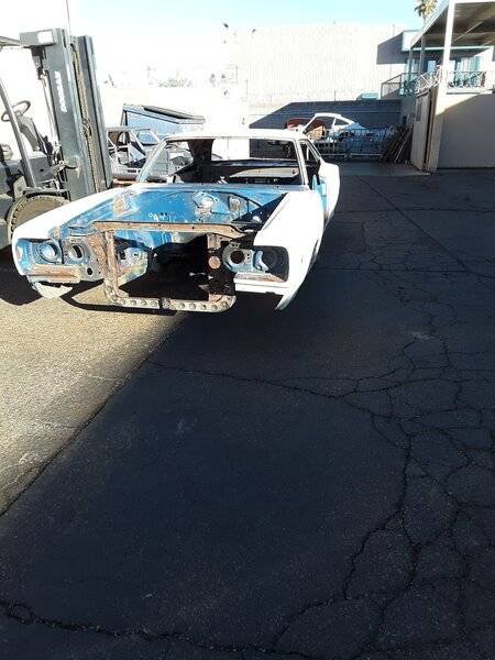

dropped the car off to get blasted and epoxy primed , hoping to have it in a few weeks . also looking to sell the built 6.4 i have to pay for paint job
