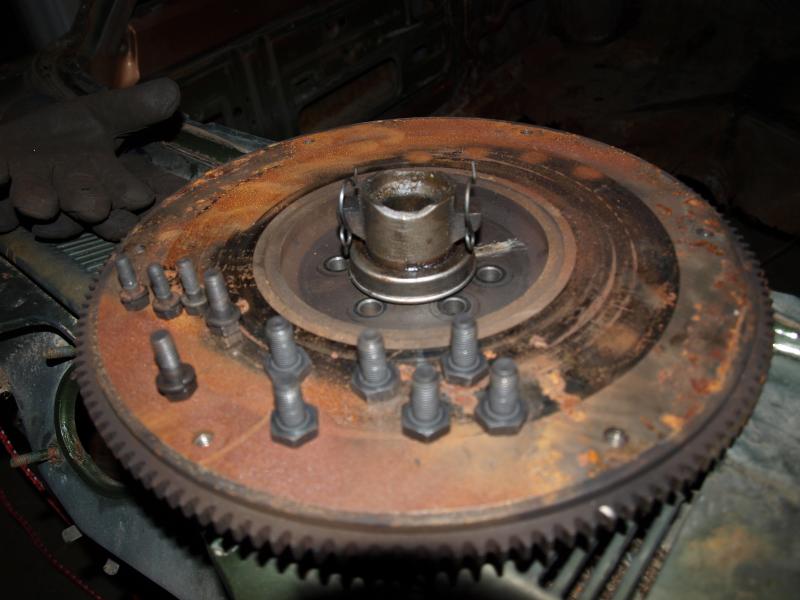

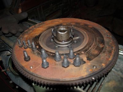

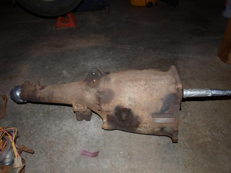

Went on a parts run yesterday and look what I came up with! The drive train is nearly complete!
Flywheel and Stuff.jpgMy Tranny 2.jpgMy Tranny.jpgOver Center Spring and Pilot Bearing.jpgShifter.jpg

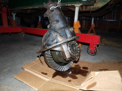

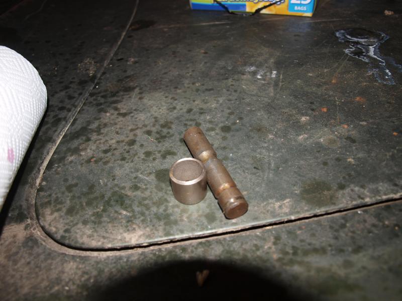

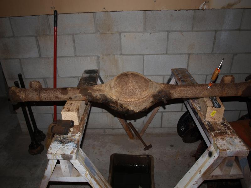

Took apart the rear axle yesterday as well. Wanted to know what chuck I had in there. The body tag tells me it's a non sure grip, but when the chunk came out it was revealed to be a cone type sure grip. A nice surprise, but unfortunately the cross pin is loose in the carrier and chewed up, so it looks like the chunk is junk! Hopefully the parts care will provide a good donor sure grip

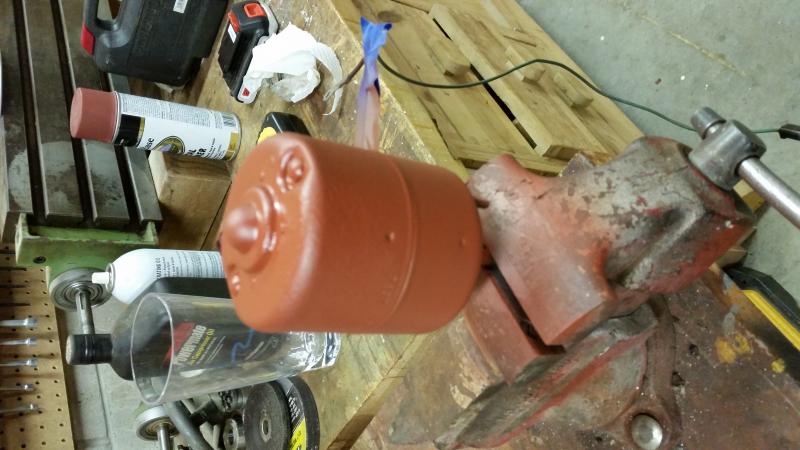

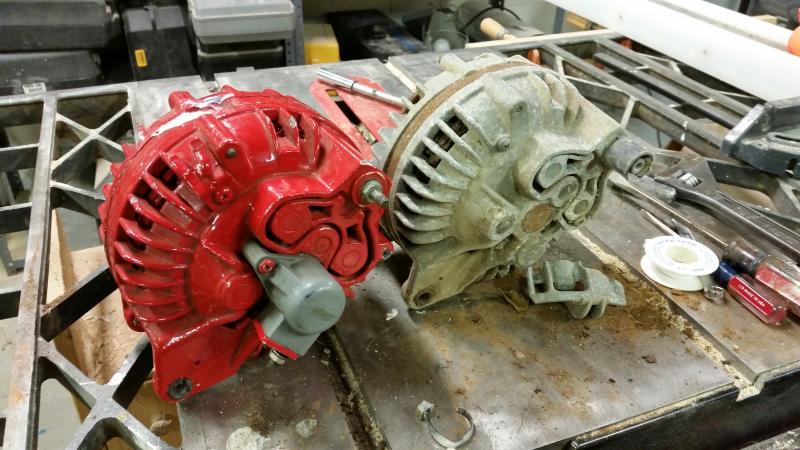

Iola car show today was HOT, literally, not too many mopar parts to be found to say the least. However I did come up with a marine mopar alternator for $10 to donate parts to my original busted up alternator. We joked all day how we couldn't find something as simple and common as a mopar alternator! this marine version was the only one I saw all day in this HUGE swap meet.
OK, there is one part restored!

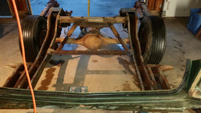

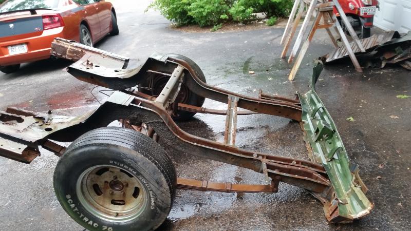

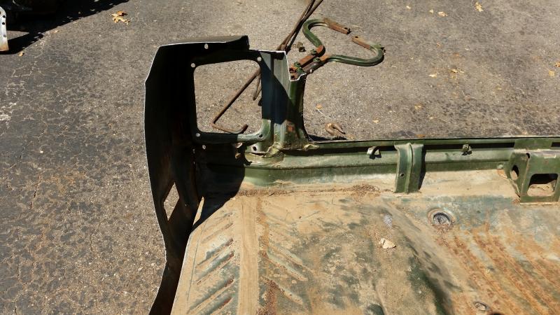

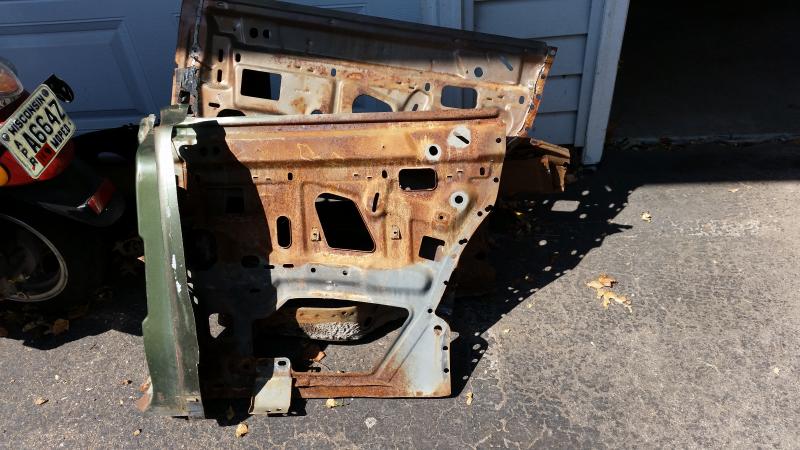

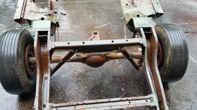

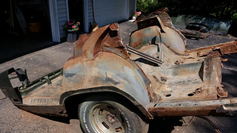

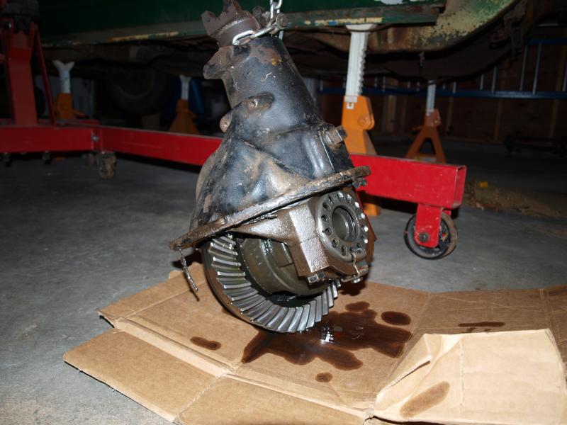

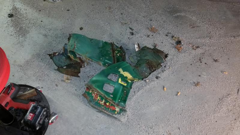

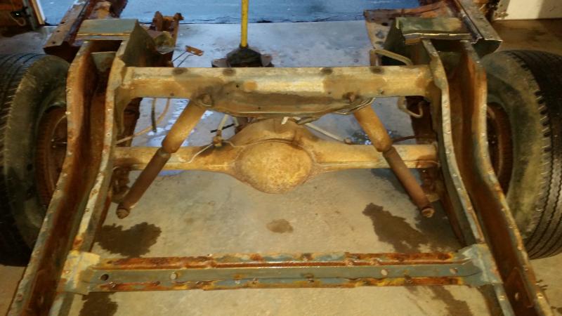

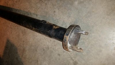

Extracting the rear axle the hard way! Not much left of the '69 'X
20150815_112754.jpg20150815_112739.jpg20150815_112721.jpg20150815_112711.jpg20150815_112536.jpg20150815_112520.jpg

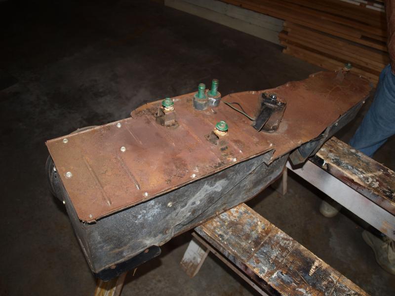

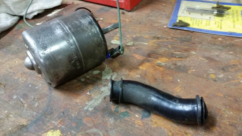

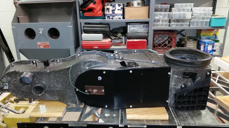

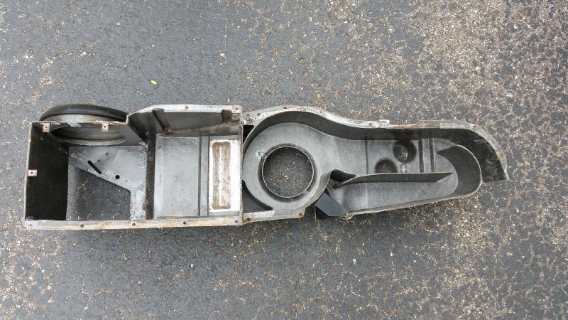

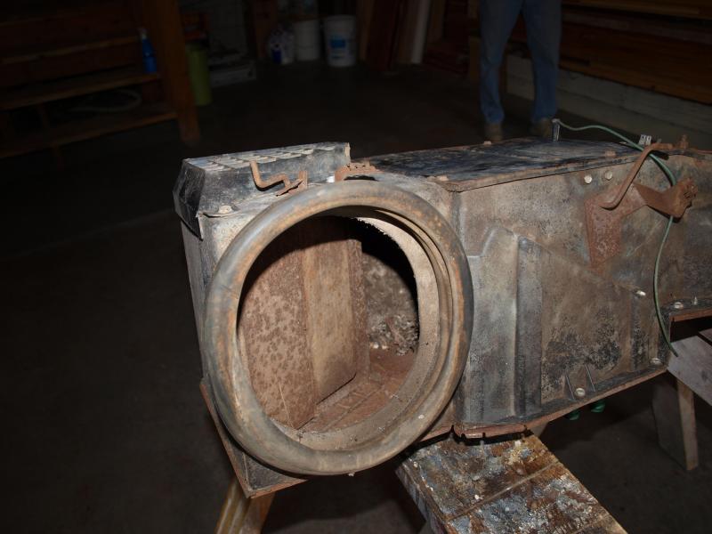

Heater box restoration on going...
of course after all these years...
not real pretty...
cruddy motor, tuned up inside and out, works well now!
looks better...cleaned up inside out out
before and after a bunch of media blasting....
Now that's better...
many many cracks to repair in the old fiberglass housing....
new seal kit, heater core, firewall nuts, and screw / hardware set in route to put this old thing back together....should get me through my lifetime after this!

ok another epic day of progress on the '69 parts car!

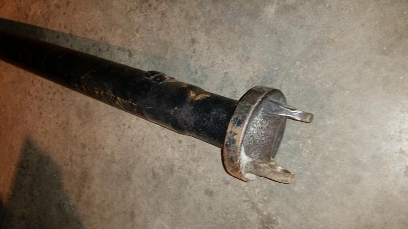

again...taking the rear axle out the hard way! :)
20150824_193533.jpg20150824_193524.jpg20150824_193514.jpg20150824_193442.jpg20150824_181418.jpg20150824_181347.jpg20150824_181336.jpg20150824_181327.jpg

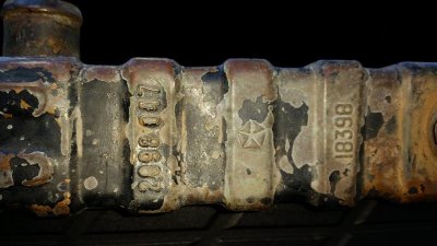

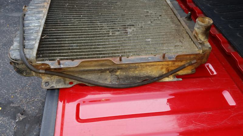

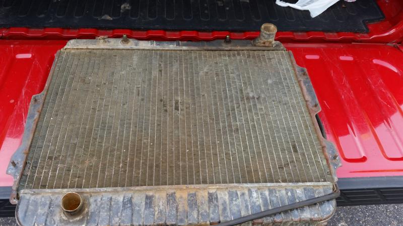

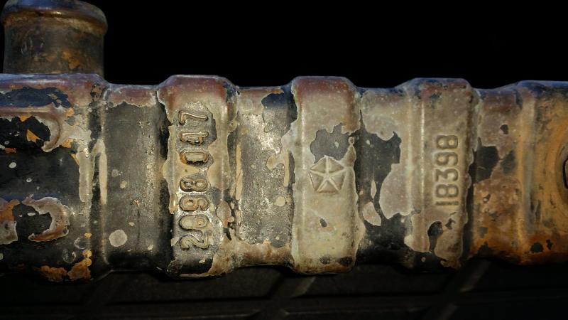

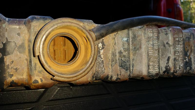

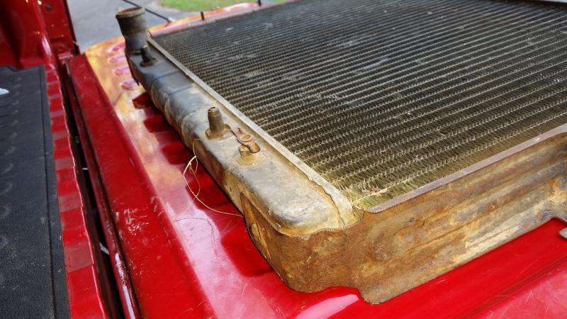

good day when score the correct OE radiator for the '68 GTX at the local swap meet20150920_172925.jpg20150920_172932.jpg20150920_172949.jpg20150920_172958.jpg20150920_173016.jpg
68 & 69 are internally balanced. They didn't start externally balancing them until 70 when they put those 900 gr. 440 Six Pack rods in. I have a 68 GTX also! Good luck with the resto! If you needreference pic's, I've got them.

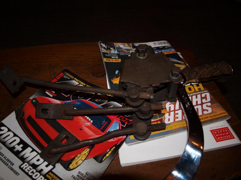

A couple more essential drive train items acquired today at the Jefferson (huge) swap meet!

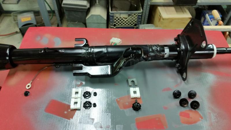

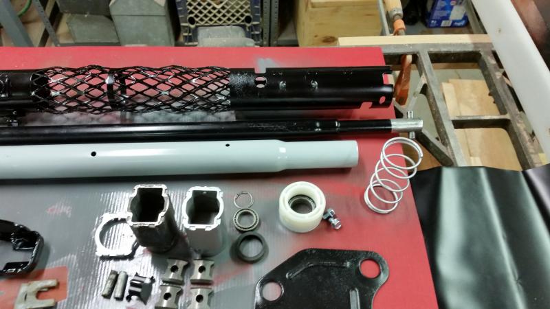

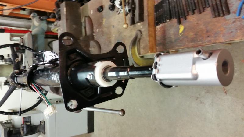

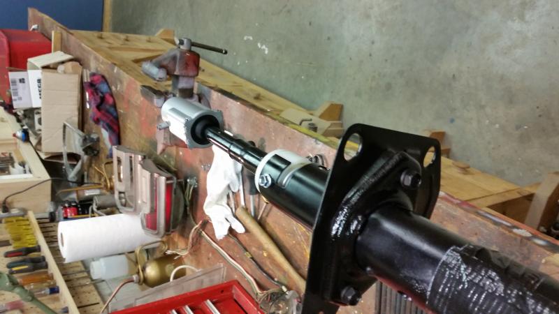

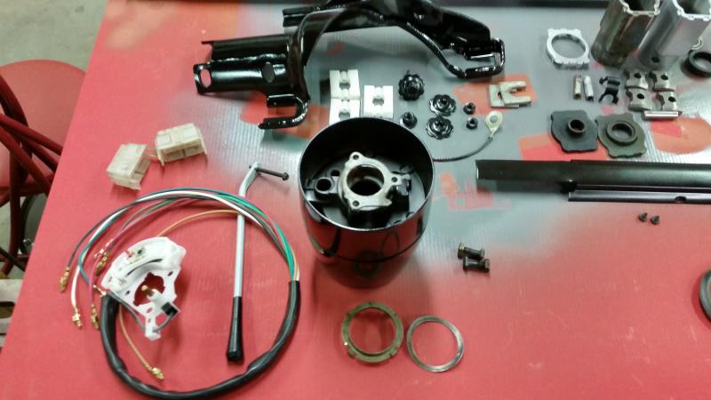

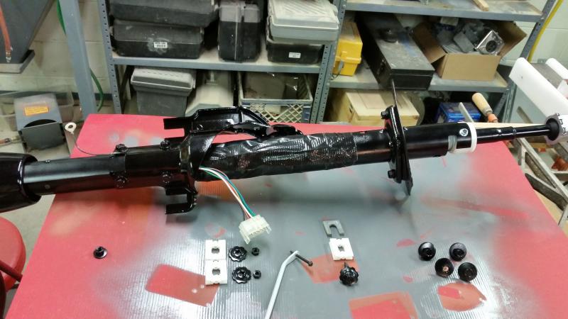

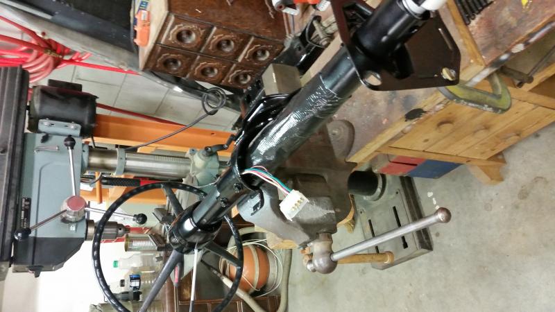

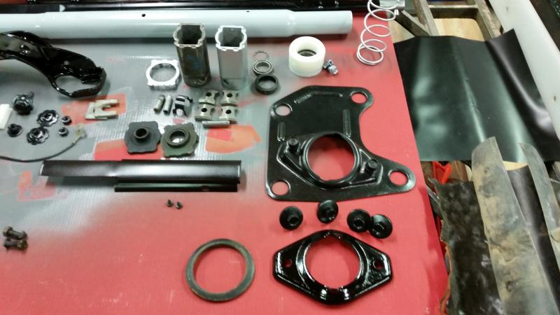

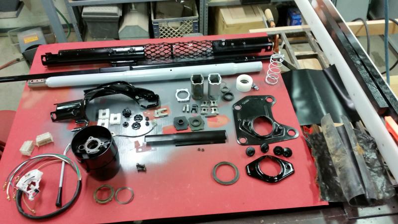

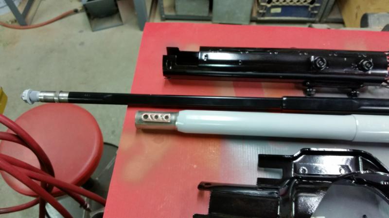

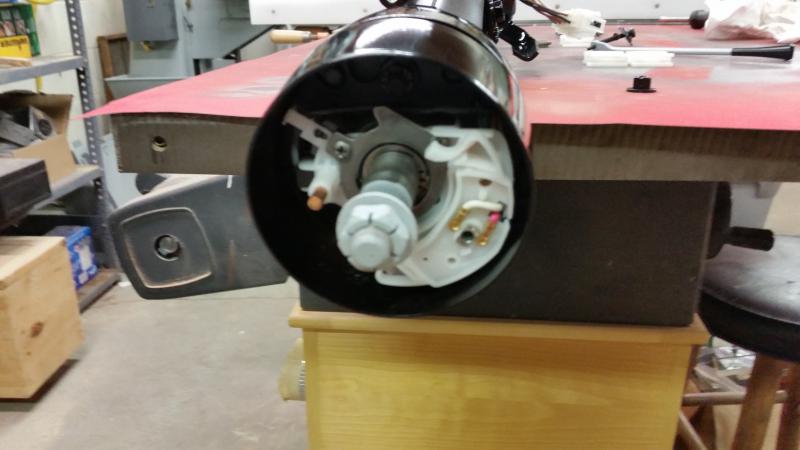

OK, getting ready to put the steering column together:
20160220_121853.jpg20160220_121849.jpg20160220_121837.jpg20160220_121831.jpg20160220_121824.jpg

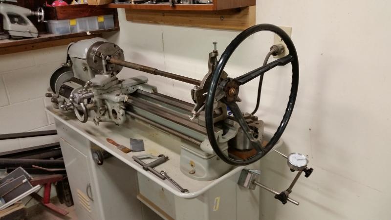

My rig for straightening the bent steering wheel...worked quite well

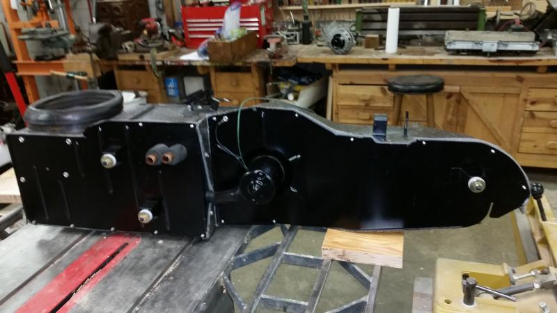

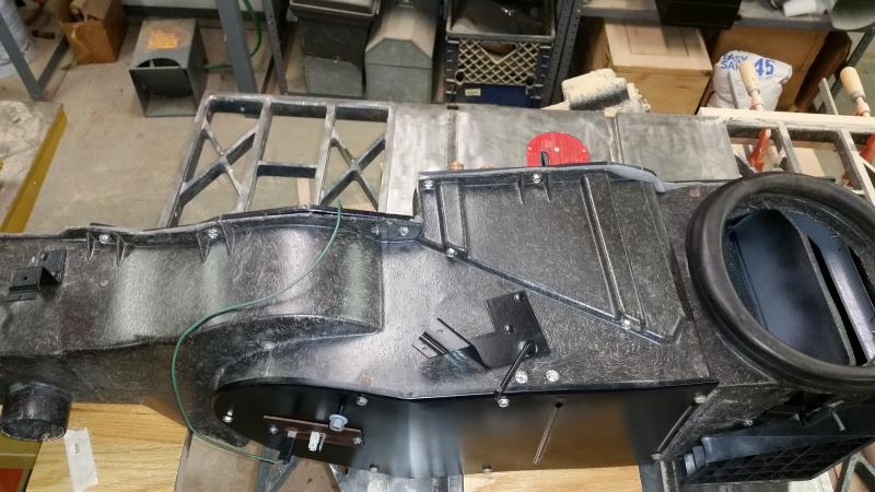

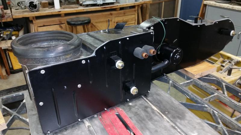

Completed Heater Box ready to go:
Heater Box Completed (1).jpgHeater Box Completed (4).jpgHeater Box Completed (3).jpgHeater Box Completed (2).jpg

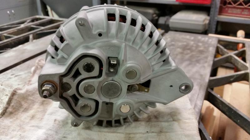

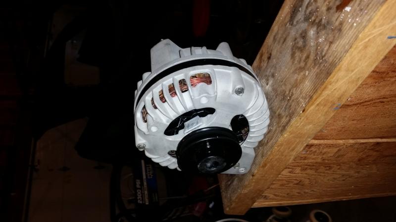

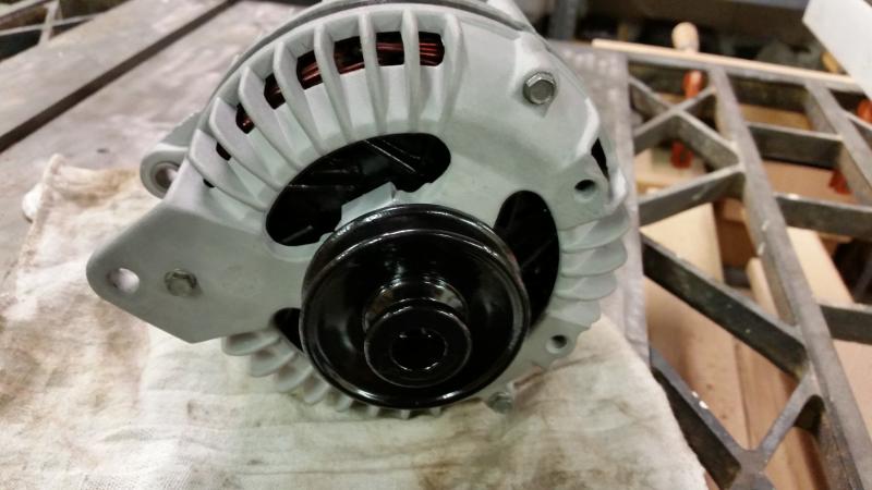

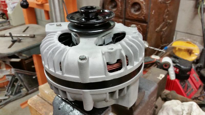

Alternator before and after....took two to make one, plus fresh diodes and brushes....works great:
Alternator (2).jpgAlternator (3).jpgAlternator (4).jpgAlternator (5).jpgAlternator.jpg

Ohh, regarding the steering column, I took a smashed up column from a '69 floor shift and the OEM '68 column shift unit and merged the good parts into a good floor shift column ...

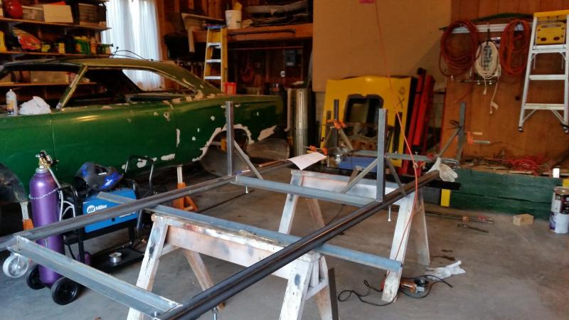

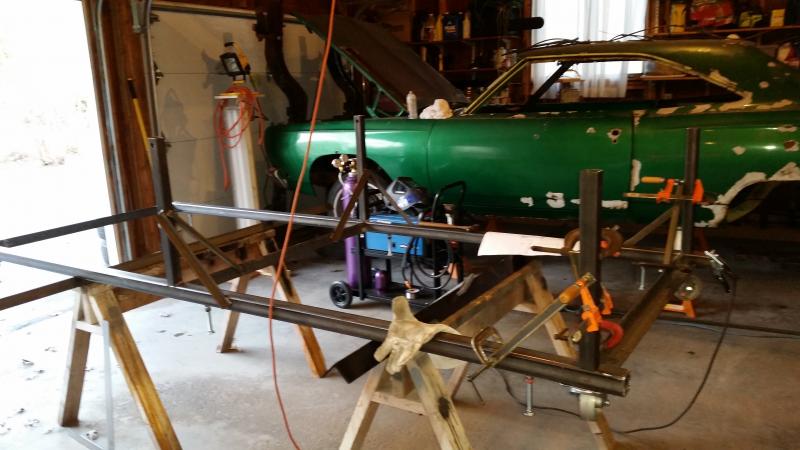

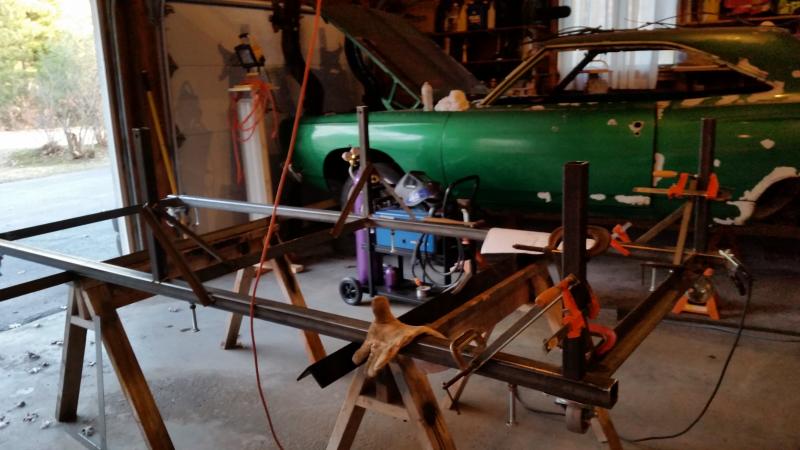

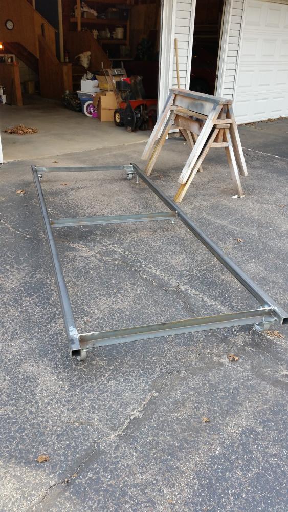

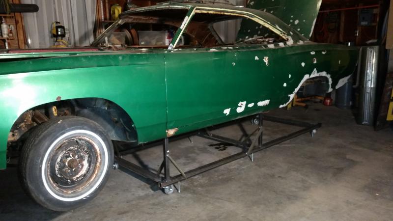

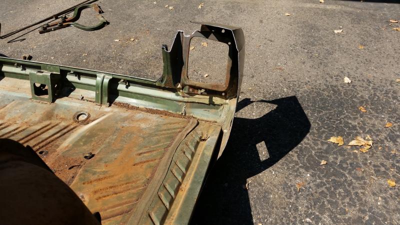

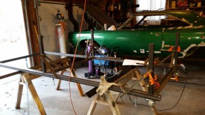

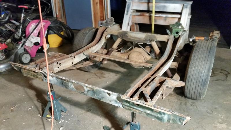

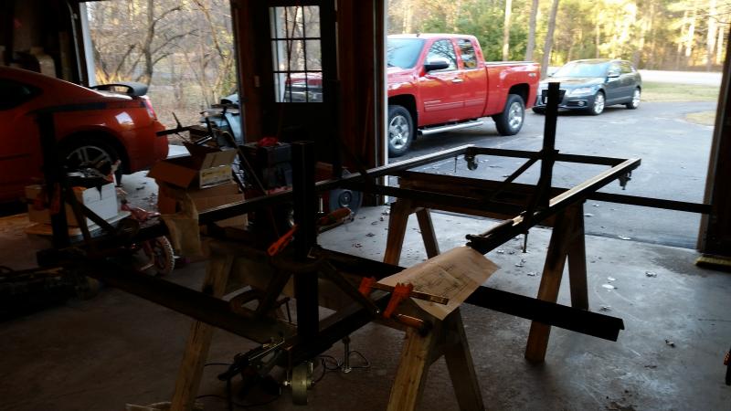

OK progress continues with a new welder and a frame jig / stand.
20160319_155125.jpg20160320_182359.jpg20160320_182412.jpg20160320_182432.jpg20160320_182451.jpg20160321_200459.jpg

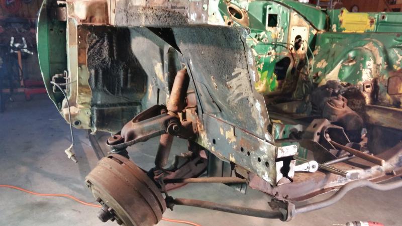

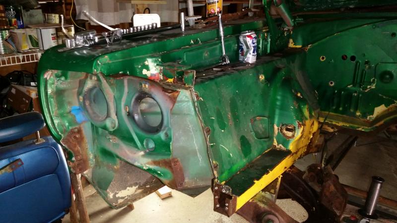

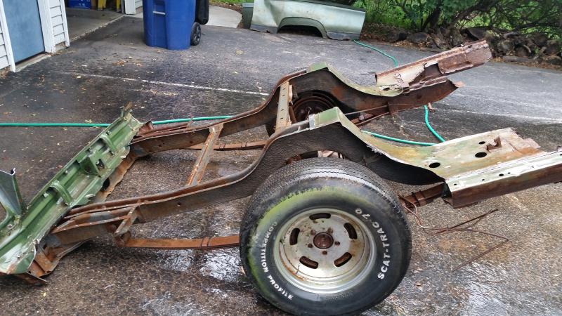

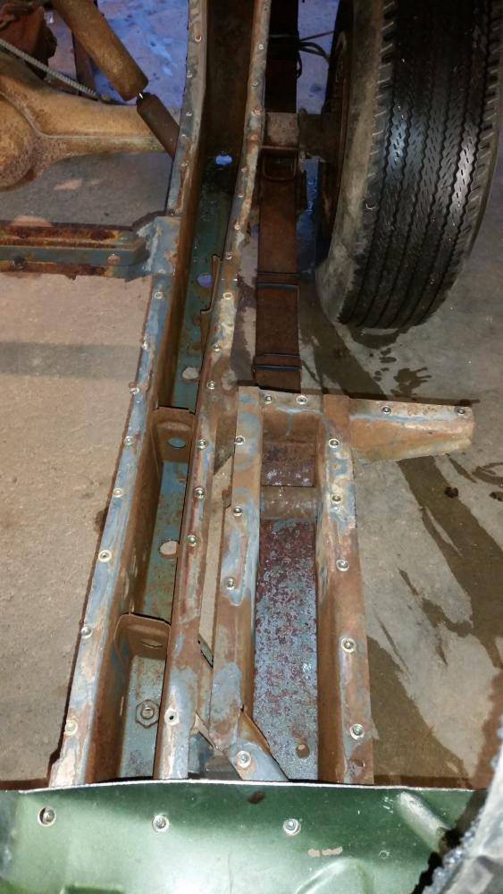

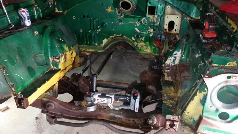

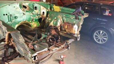

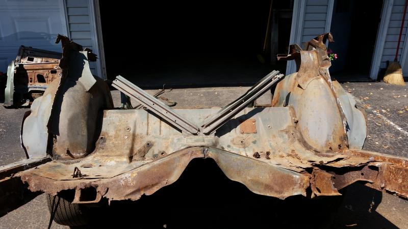

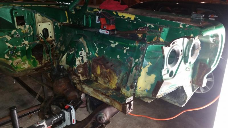

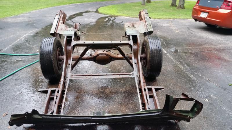

Since on the frame stand, I have unloaded some forward weight to better balance rig before I level it all up and start cutting out the rear frame members. So this is the front end minus a lot of metal.
so yeah, that is a pile of scrap metal that did at one time resemble a radiator support.

The steering column came up real nice. :notworthy:
You have been busy to say the least, keep up the good work Rakort. Great progress.
wow, didn't know that was possible! Great attention to detail.
It did come out well, thanks. I actually let my 84 year old father do most of the work. He is a detail nut and an old car guy.... he actually worked for Chevy in the day as a field service engineer. That's where I get it from!
So the 50 year old fiberglass heater box was a pretty hot mess. It was quite brittle and full of many many cracks. There was a many many small fiberglass patches performed on the interior of the box.....can't even tell from the outside. Should be good to go for another 50 years.....now if I can just find a stencil for the part number that goes on the cover.

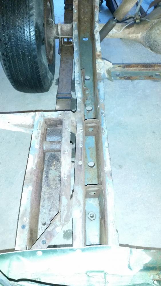

Suspension is in the process of being dropped out
