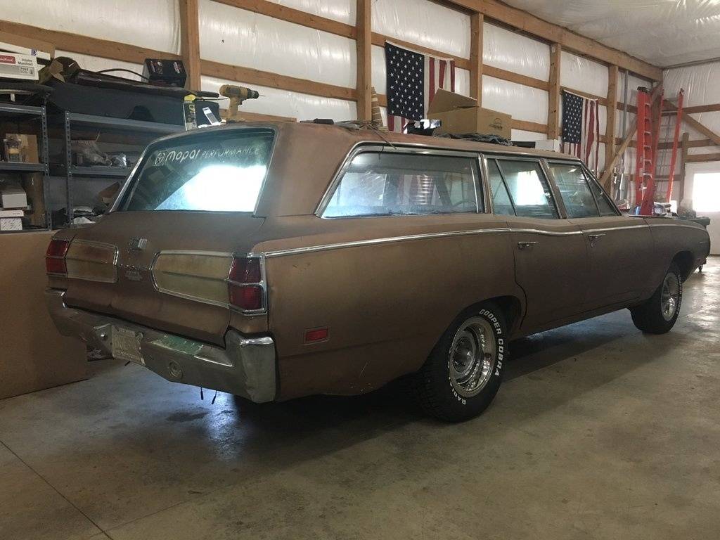

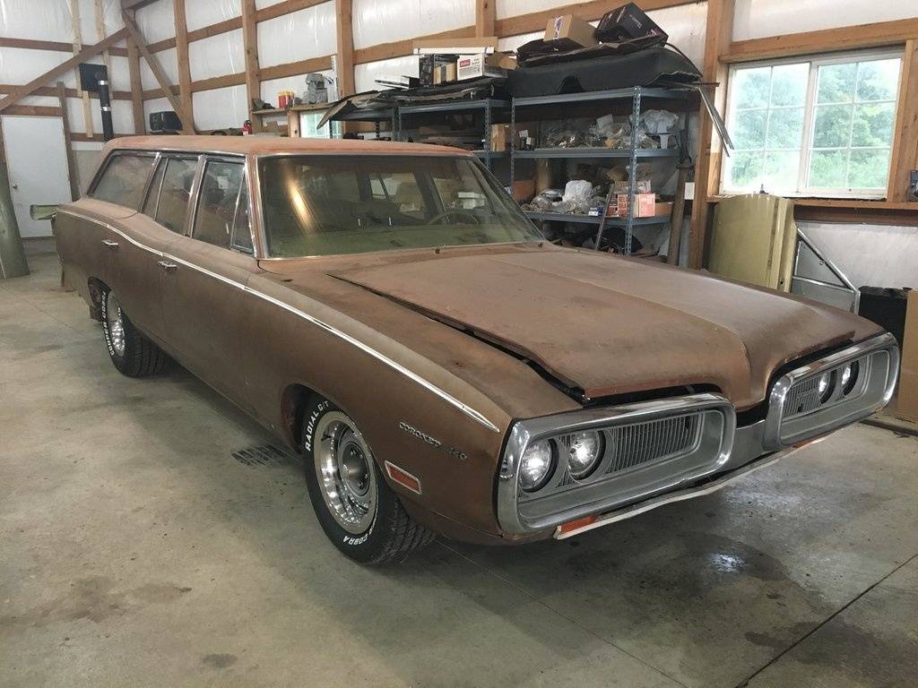

Now that I'm back from my Cancun family vacation, here's some pictures of the wagon in its current state.
Tailgate is rebuilt and hung. Glass motor works from both key switch on gate as well as dash switch.

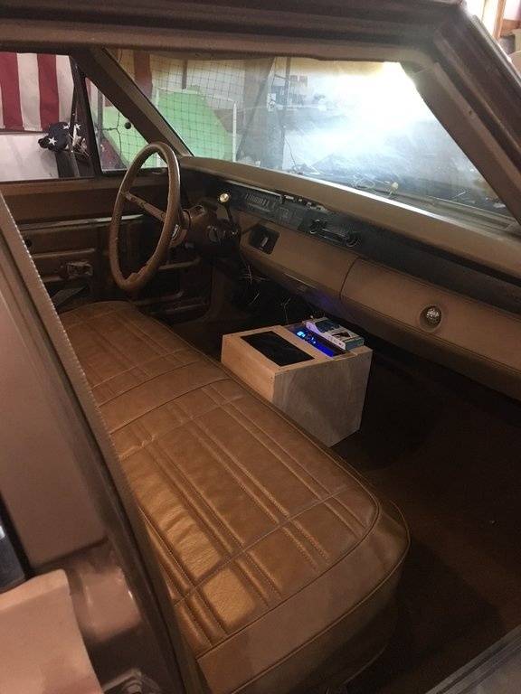

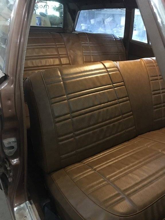

Here's a few pics with both seats installed.

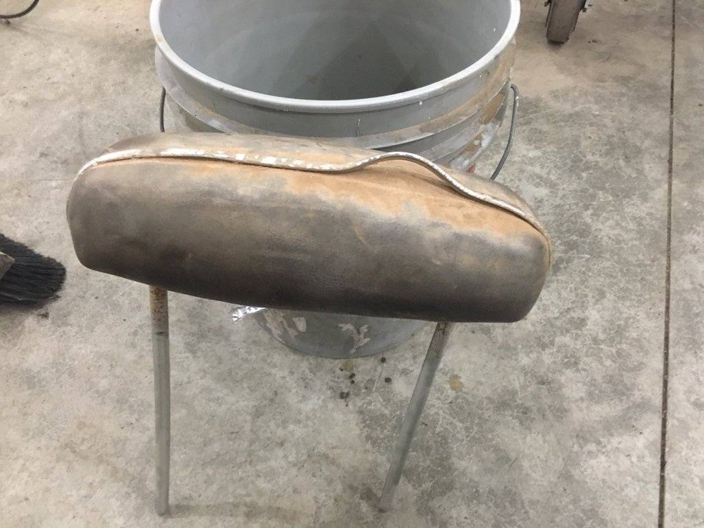

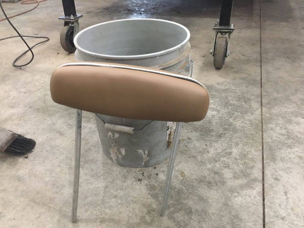

I also had to clean and repair/paint the headrests. Can't really fix the "chrome" finish on plastic trim pieces, but this should be sufficient for my driver for now. Before and after pics of one of them.

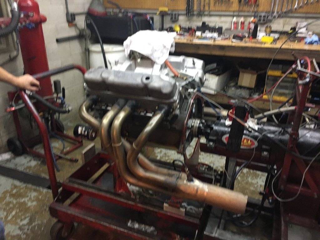

My brother helped me get the engine dyno'd and tuned this weekend. I'm very happy with the results and excited to get it painted and home for install.
Smart man! Worth the time and cost to eliminate any problems or leaks prior to putting into your car....
I'll keep tinkering with the small items until the engine is ready to come home.
you can get that chrome from classic ind. for about $50 and it will make the headrest look brand new. Probably can get ir somewhere else for $20 if you know what to ask for, it has 3M adhesive backing.

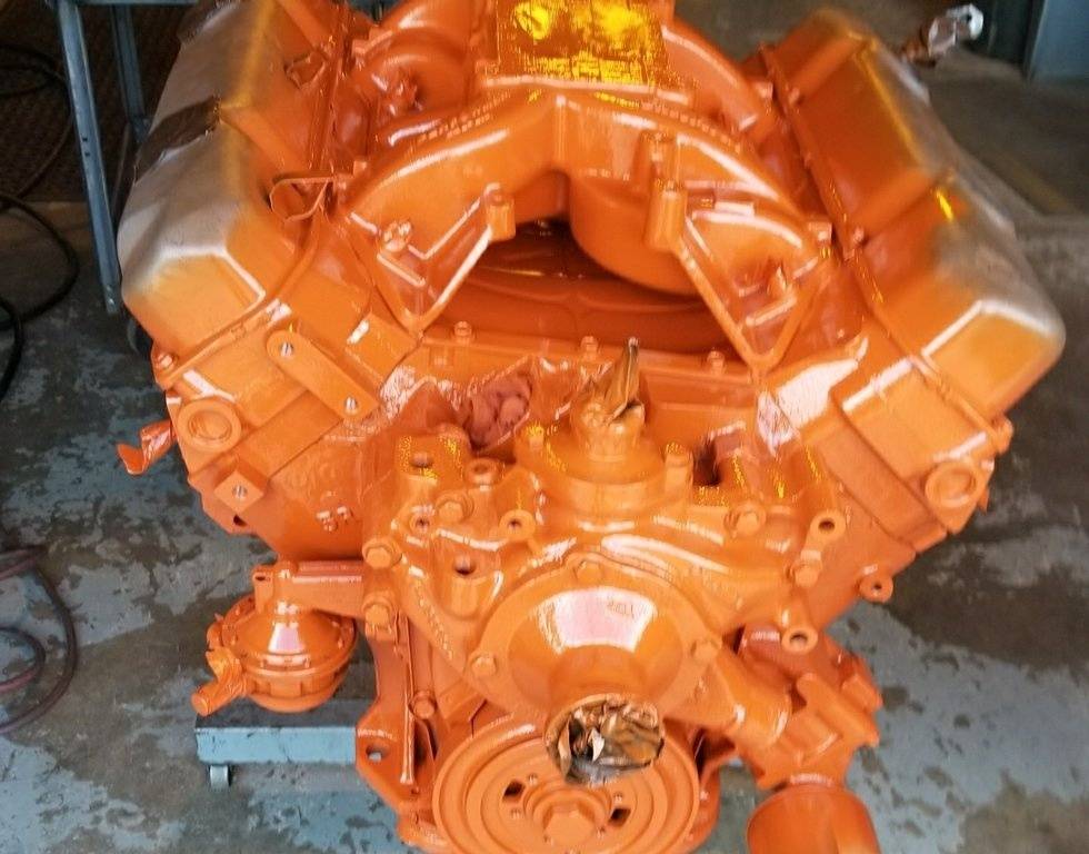

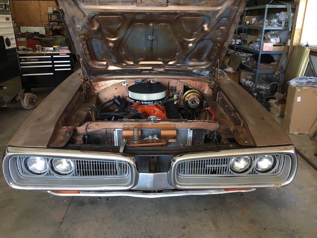

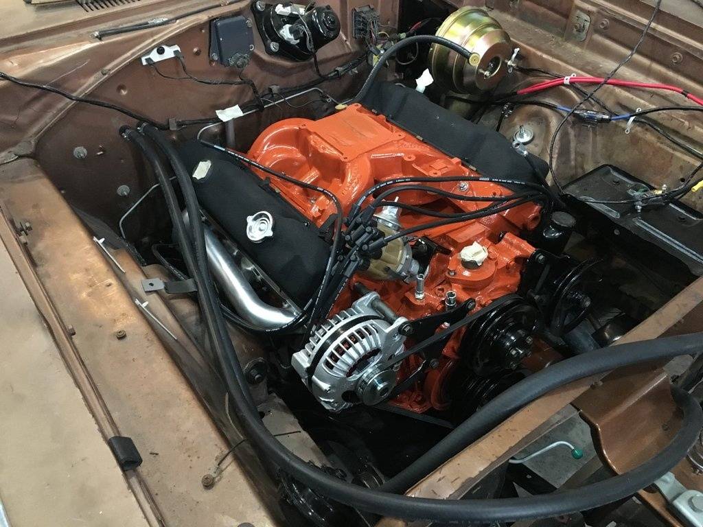

I'm making some progress. Here's pics of the engine painted and put in the car.
Hopefully I'll have engine buttoned up in a week or so and move onto getting exhaust installed.

So the engine and tranny hook up is about 95% complete. All that's left is modifying the throttle cable linkage that mounts to intake due to the dual plane intake, connecting fuel line and filter from pump to carb and figuring out if I have what I need for electronic ignition.
Everything worked out for clearance between air cleaner and hood with the work my brother did machining the intake and the custom work done to the top pan of the air cleaner.

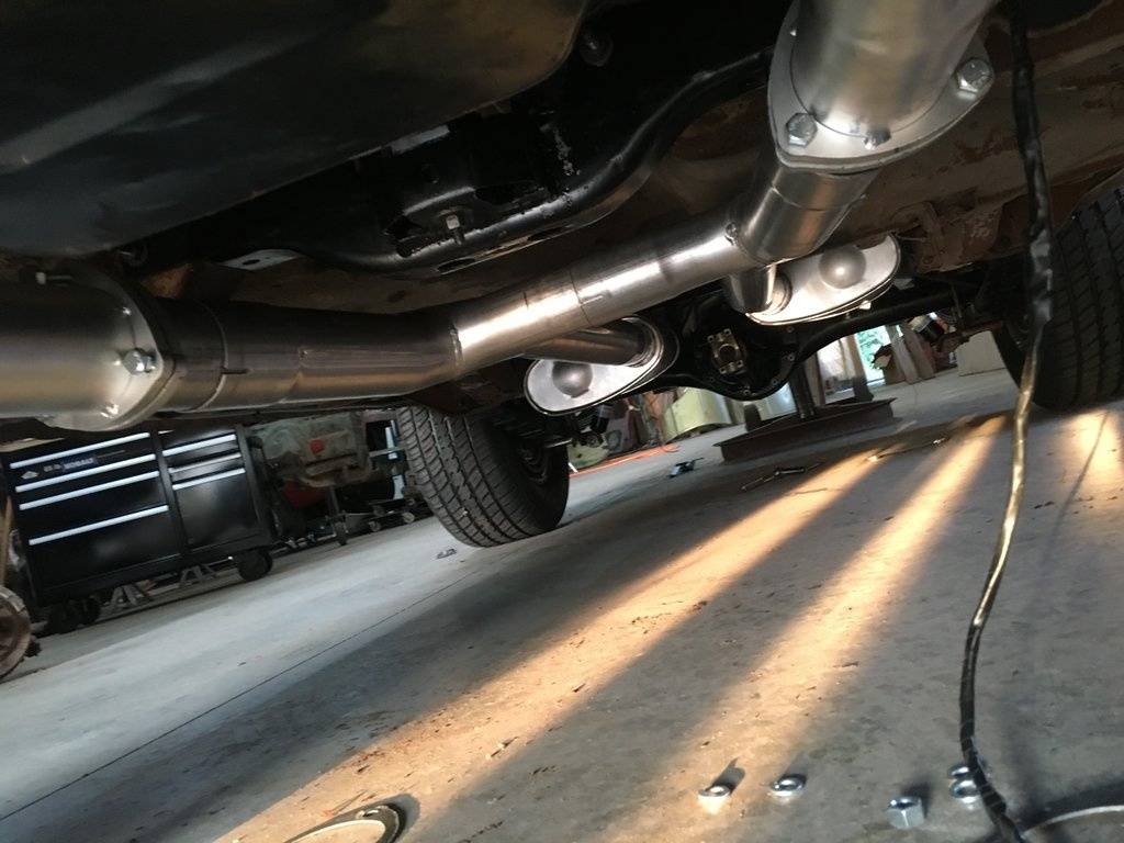

Well I got the exhaust installed, bought a new driveshaft and finished the brakes. Got the old girl running finally. I took her on a test drive to the local gas station tonight with no issues. I'm very happy to have the wagon on the road after all this time and I owe my big brother so much for the countless hours of help.
