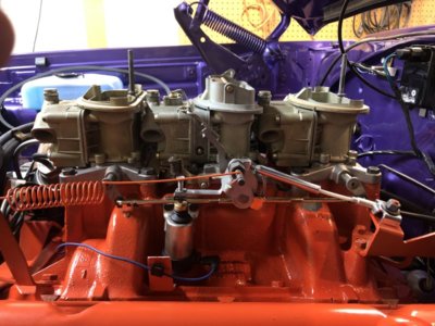

Here is couple of pictures

I would adjust outboard carbs to make sure they are closed. Then adjust or remove high idle solenoid so it’s not holding open center carb. Then just work on center carb til it’s correct. Then move on to outboard carbs.
linkage that ties the carbs together is probably tight letting one of the end carbs hang open.
The idle adjusting screw is where the arrow is pointing. This assumes you backed off the adj screw @ the idle solenoid. Kinda agree with lewtot184 about that linkage, looks like front carb is not fully closed (circled). So if your choke has unloaded these can be the only adjustments assuming no vacuum leaks.
Here's the idle screw on my carb (arrow).
The rods that go from the center carb to the outboard carbs may be holding them open more than they should. Try adjusting the length of those a half turn at a time.
You sure your choke is unloading off the fast idle cam (arrow pointing toward it)?
