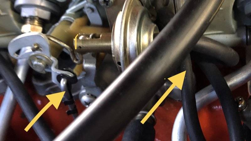

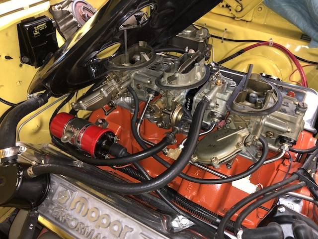

Here is my super bee 440 6 pack set up
Do I have the vacuum lines correct?
Where does the line from vacuum port top middle carburetor go to?

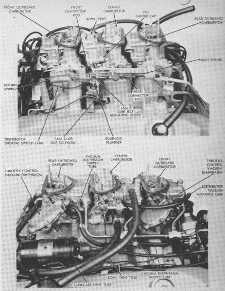

The enclosed bowl vent hose would connect to a three-nipple breather cap or evaporative recovery system if present. If not, the nipple should be left open to the atmosphere.
The hoses connecting to the outboards from the tee have to be the same length.
