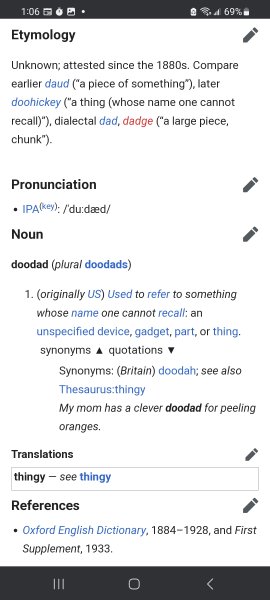

Doo dad's?
Doo dad's?

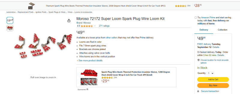

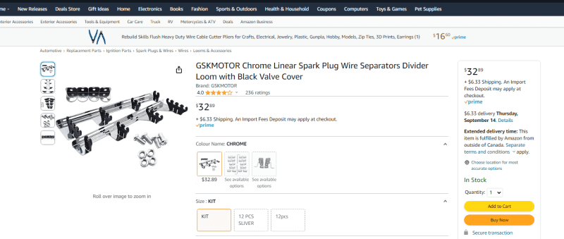

Yes perfect I found some on amazon, I'm figuring out which to go with. Thanks guys!
