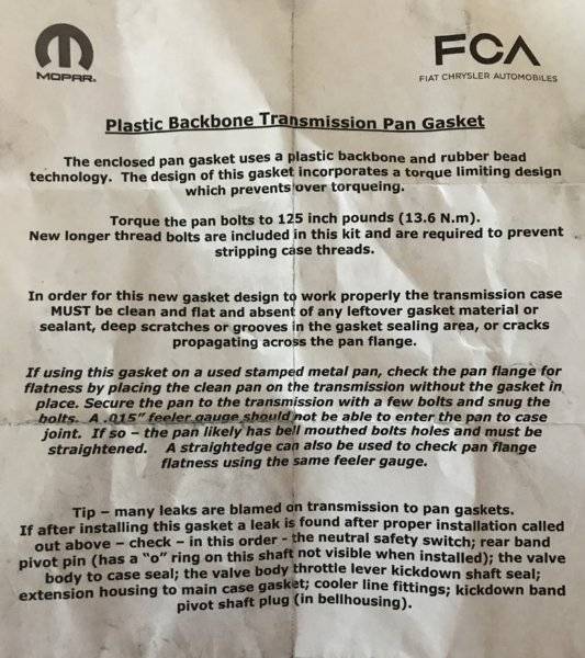

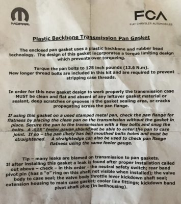

Reusable pan gasket. Needs longer bolts and torque specs are 125 in-lbs. I have the MOPAR instruction sheet, I've attached it. :)
