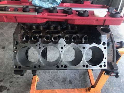

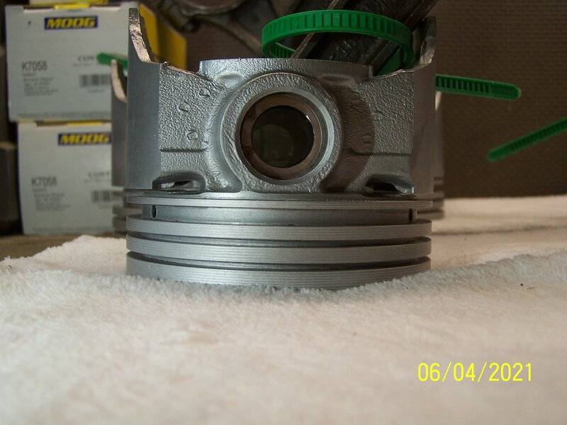

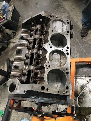

Block is at a friend's shop getting cleaned up. I took the pistons and all the other small parts home so I could clean them and not be in my friend's way. They race every weekend so the shop is a little full and really busy on Friday nights. Less of my stuff there the better for them. Anyway, I finished soaking and cleaning 4 of the pistons (the other four are soaking now) and they just need a little final cleanup.

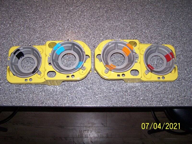

Head light brackets finished up

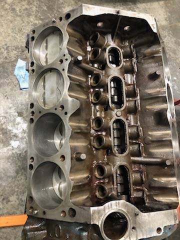

Power washed the block

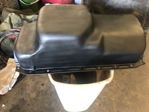

Oil pan blasted and primed

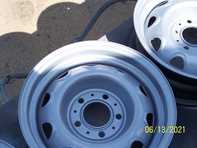

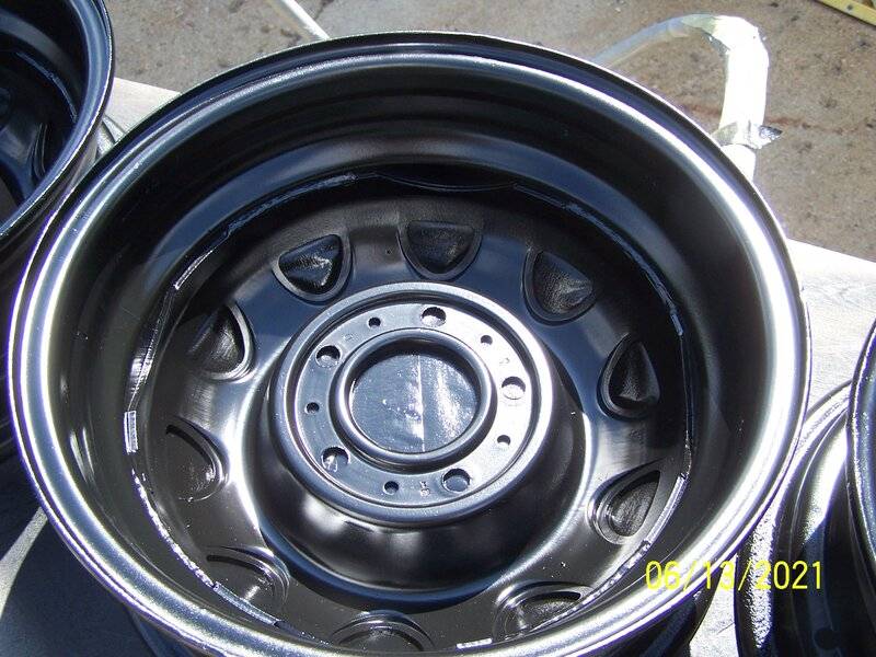

Got to the wheels today. Painted the back side in the AM
Front side in the afternoon.
Little closer look. The light has everything to do with the look and the bounce off the metallic.
Four wheels wont stand like this so you only get three. I like the way they turned out.

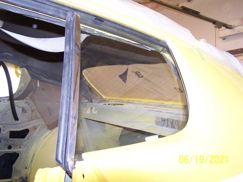

Switched back to my shop and put in the 1/4 glass and then set the window gaps.

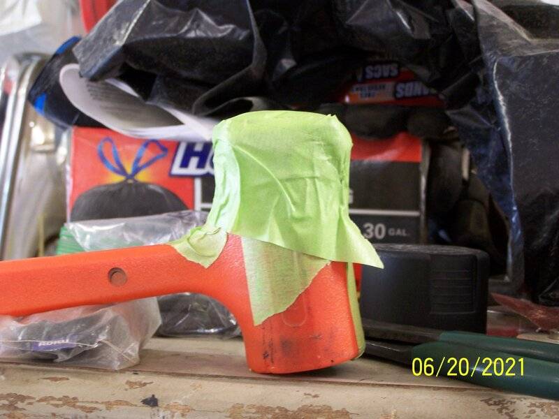

Only took a few minor adjustments to get the window to seal properly. Next, the wife and I installed the drip rail chrome strips using a taped up dead blow. Sorry, only took a pic of the right side.

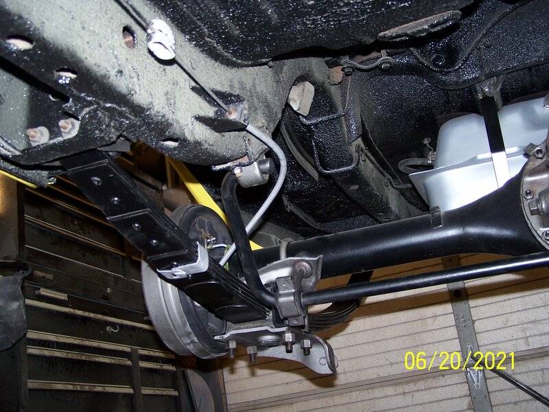

Got the rear sway bar bolted in and also took time the make sure all the E-Brake cables reached and worked.

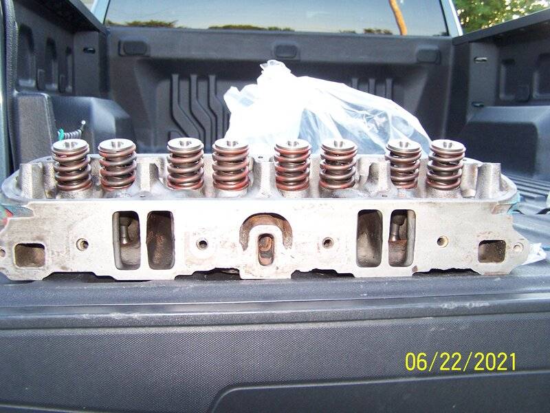

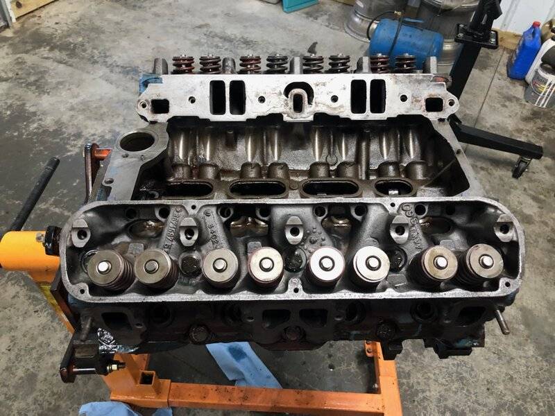

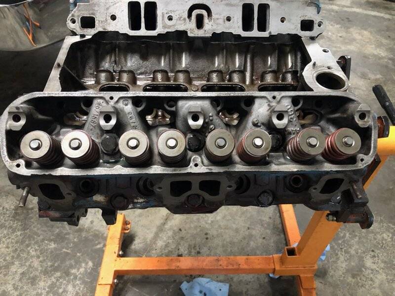

Good news, bad news kinda thing. Good news, my heads are done; bad news, they cost three times what they were supposed to cost. Original valve grind was $200, but once they added all new guides and resurfaced them the cost rose to $600. Like dad always said, "If you are going to do it, then do it right or you'll be doing it again!" They do look good.

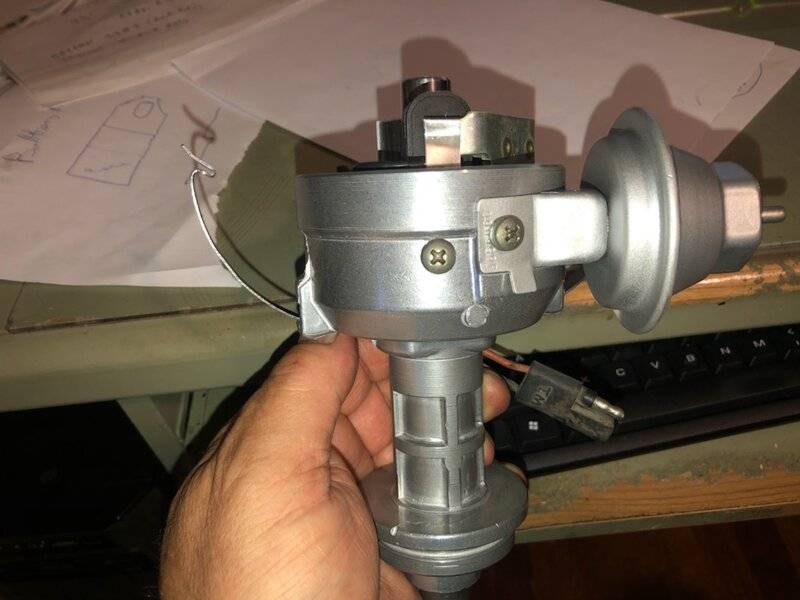

More good news, bad news: The distributor is done and on its way back to me but the new cam bearings did not come in today as I was told they would. Should be here tomorrow, maybe.

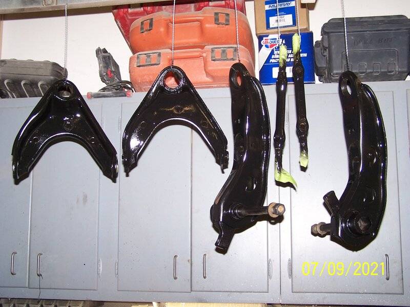

Now for the stuff that blows my hair back. Was cleaning the torsion bars and found the factory paint ID marks.
Also found time to paint both the fender braces.

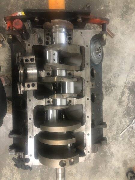

With that done, the crank was next.
Then the pistons, and by then it was past 11 and time to quit for the night.

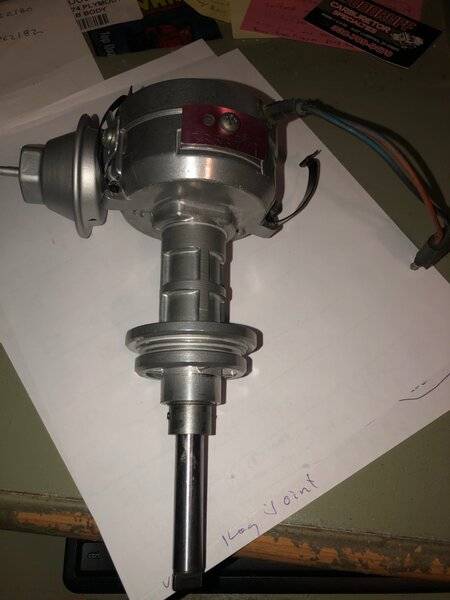

Forgot, I got the distributor back and never put in a photo'

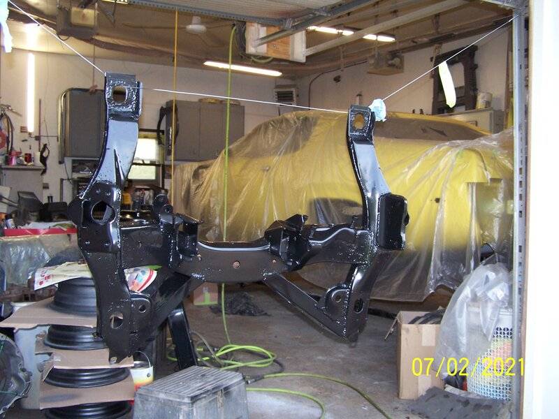

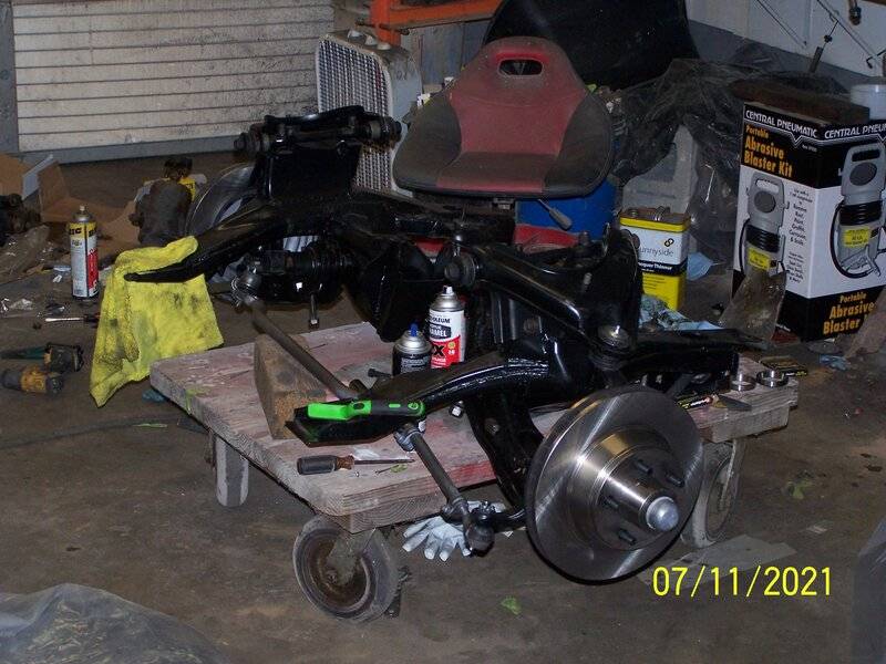

Need to get the front suspension done so I grabbed the K-frame out of storage and started to prep it.
Primed with a rust stop that needs 48 hours to dry before I can spray it with semi-gloss.

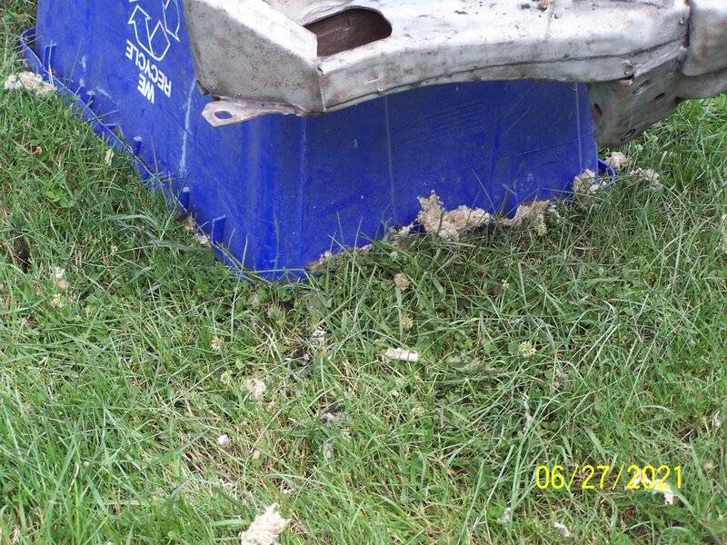

I know every animal has it's place, but I could do without the mice making my K-frame their "place" as they
left a ton of crap behind when they left.

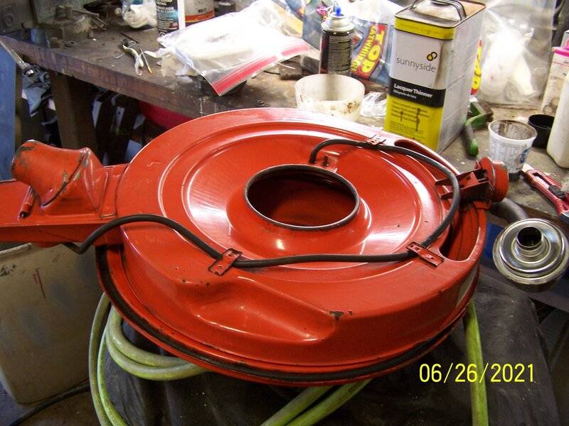

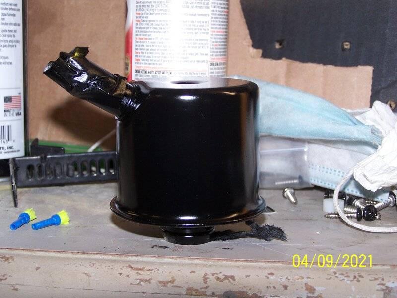

Also dug out the air cleaner. Looks okay but not quite good enough so it will get blasted, a re-spray, and new decals.
And the correct air cleaner for the crankcase vent:
I am a little slower at this than the guys who own the shop. I just finished putting my heads on and in that same time the two of them finished a race engine that only had the crank and cam in it. Plus they took time to answer all my MOPAR questions.

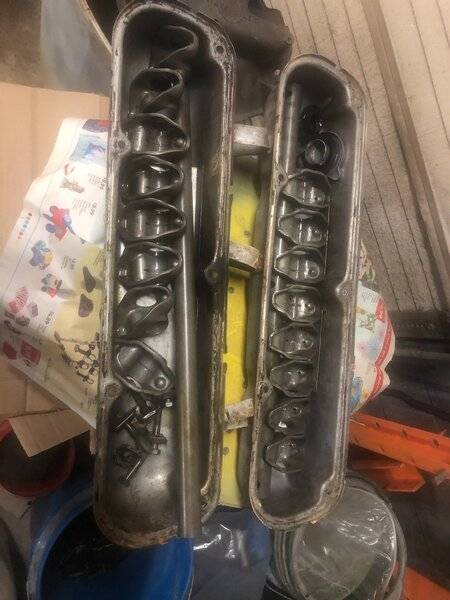

Rockers are cleaned up but the valve covers still need some work.

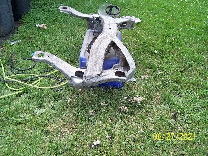

K-frame got sprayed today. It looks like gloss in the photo but it will dry down to the semi-gloss that it is. You would think in a small garage it would be hard to lose a piece but I lost the starter splash guard. I blasted it and sealed it but now I can't find it anywhere. %$@#*$%$

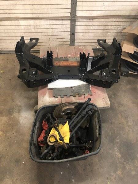

K frame on the cart ready for building out

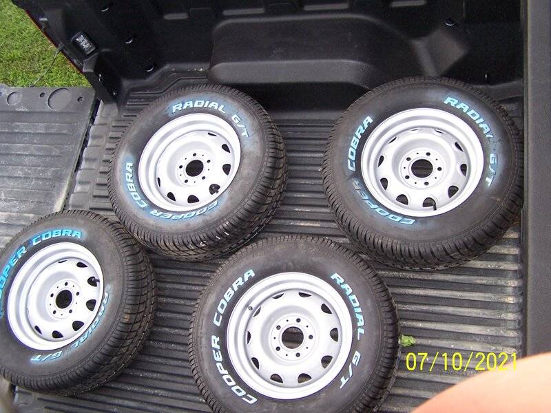

Tires mounted and balanced

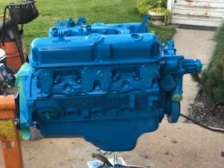

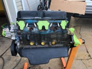

Motor is just about together

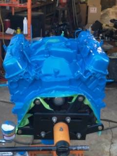

A few more project pics. I broke my own rules and tried a paint I have never sprayed before. Supposed to be more durable as an engine paint. We will see. It is Delfleet Essential single Stage Polyurethane enamel that is a 6:1:1 mix. And they had the mix formula for Chrysler Corporate Blue. The pics may not show it so well, but it is SPOT ON for color.
Looks good in blue
