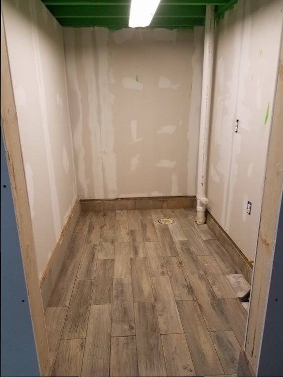

Last night was spent on the bathroom, laid the tile, hung the rest of the drywall and got the first cost of mud on. It'll only take a skim coat then paint and I'll be ready for the toilet and plumbing.
Notice the Sublime green ceiling:thumbsup:. I'm hoping to find a paint that will be close to an aluminum color for the garage and bathroom walls?
A big obstacle is going to be figuring out how to install a bladder tank, pump and hot water heater without it looking messy.

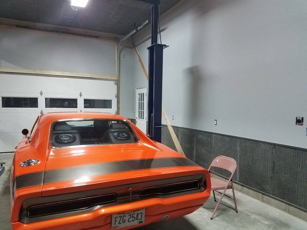

She's painted:thumbsup:. Call me cheap but I bought 5 gallons of Kilz primer and after a good coat I had a ton left so I went threw my left over paints from the house and poured in some more white and black to come up with this gray... $50 to paint and prime the whole garage. I've got enough for another coat so I'm thinking about getting some metal flake to give it more of a silver look? At any rate I'm at least past the dusty stage which is great. Hopefully I can finish it next weekend with trim and move on to the floor.
