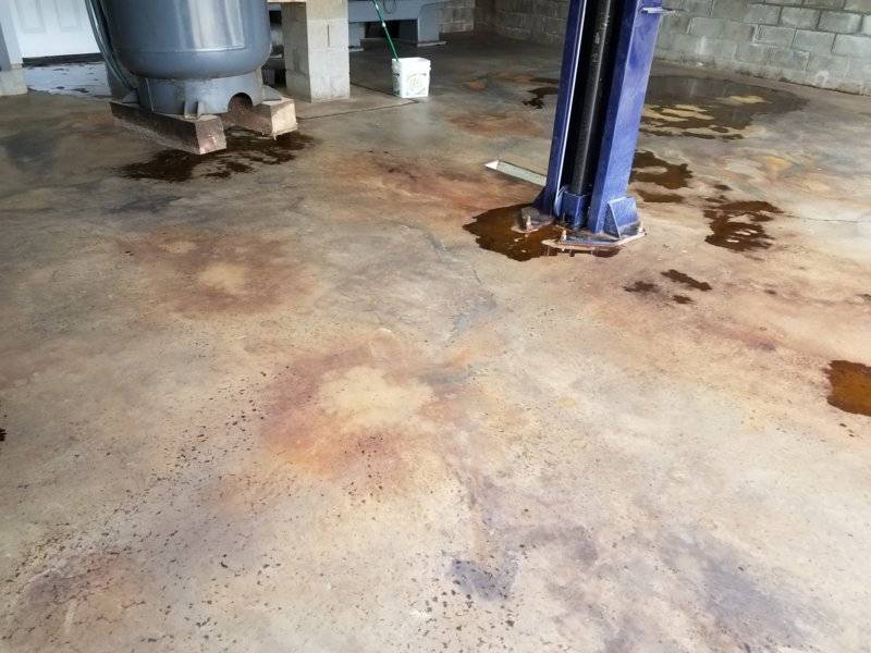

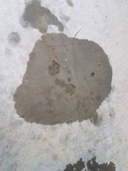

Having a years worth of oil drops, paint dribbles, etc meant a very thorough cleaning... no fun. I spent a day scraping, sanding and scrubbing the floor with TSP and to my surprise zero oil spots showed up. I also found that puddling lacqer thinner over the oil stains seamed to raise the oil to the surface where it could be wiped up:thumbsup:.

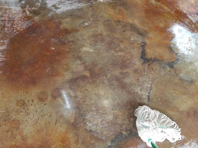

For the color Slate was the goal, I used black stain diluted with enough water to achieve the dark gray then would pour mutiple undiluted stains into the Black stain while wet to get a natural looking flow. In some areas the contrast was a bit much so a second coat of black was applied to soften the contrast but in the end I'm pretty stoked with the results. I do however have some blemishes to resolve, minor but still want them dealt with. How is the question, I've scraped, sanded and reapplied stain with no luck so I'm leaning towards just touching them up with paint or die before sealing? Waiting to seal it now, pictures to come.
Here's a bit of a sample, really hard to capture the entire floor since it has to be wet to really show the color but you'll get the idea.

Here's a picture showing how the lacquer pulls the oil up, this is a stain that had already been scrubbed and you can still see oil being brought to the surface.

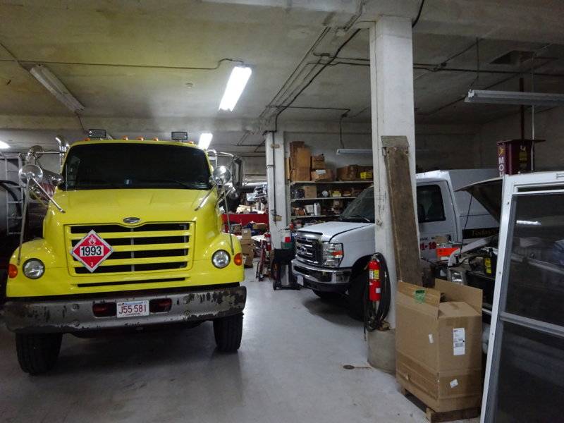

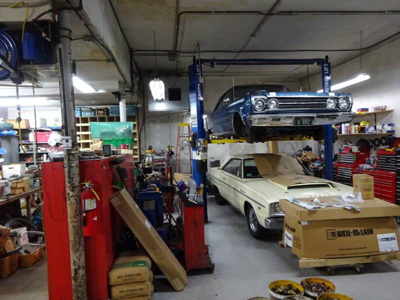

I'm going to suggest not having any duct work at all. My shop is very big, 75'x125'. I have one waste oil furnace set way out of the main area with the intention of adding ductwork later. I never added it because the shop heats just fine. If you want to sit way off in a corner and watch TV, you might notice it's not as warm, but in a shop, you are always moving around and will never notice it. The first pic is standing at the front looking down the shop, you can just barely notice where the noses of the blue and yellow cars are behind the wall
. The second is looking down the bay of where the cars, are the furnace is in the upper left. The bay is about 20'x20'. With all the stuff in the way (trucks and walls) the heat gets everywhere. I think you'll be happy with the heat distribution and with not having duct work taking up valuable space.
I'm going to suggest not having any duct work at all. My shop is very big, 75'x125'. I have one waste oil furnace set way out of the main area with the intention of adding ductwork later. I never added it because the shop heats just fine. If you want to sit way off in a corner and watch TV, you might notice it's not as warm, but in a shop, you are always moving around and will never notice it. The first pic is standing at the front looking down the shop, you can just barely notice where the noses of the blue and yellow cars are behind the wallView attachment 598993 View attachment 598992 . The second is looking down the bay of where the cars, are the furnace is in the upper left. The bay is about 20'x20'. With all the stuff in the way (trucks and walls) the heat gets everywhere. I think you'll be happy with the heat distribution and with not having duct work taking up valuable space.
Easy enough, I'll start out with just a 90 so it's at least blowing out and not against the ceiling. Don't know how much difference it will make but it will also deliver central air as well? I do have 2 ceiling fans too so I'm sure that'll help.
I have A/C too. If you look at the second pic, in the upper left behind the two blue reels there is an A/C unit with no ductwork either. This blows down the length of the shop and also works just fine.
