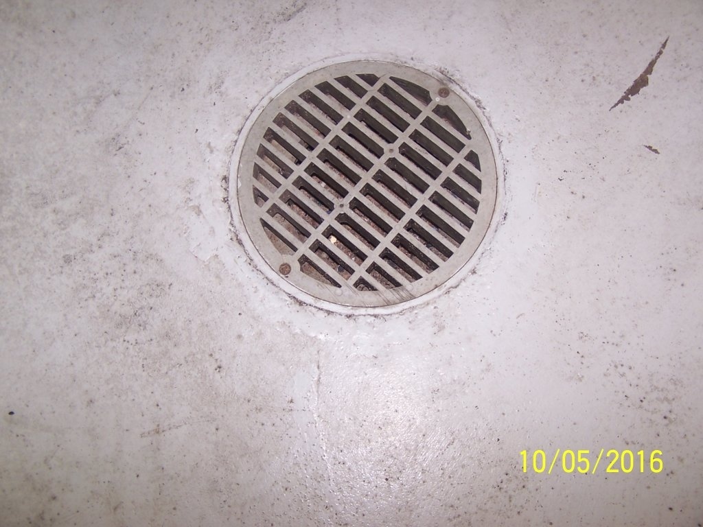

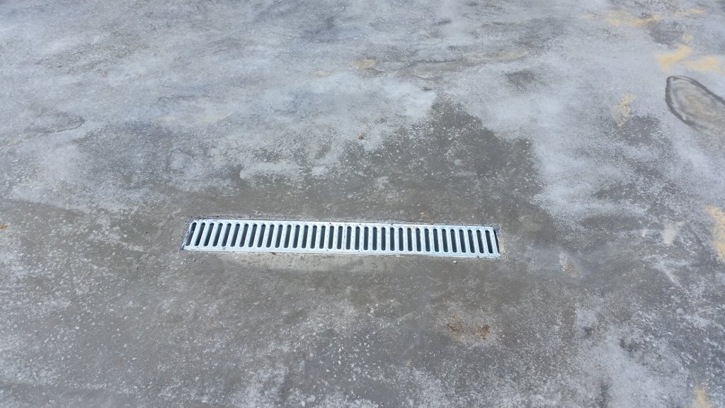

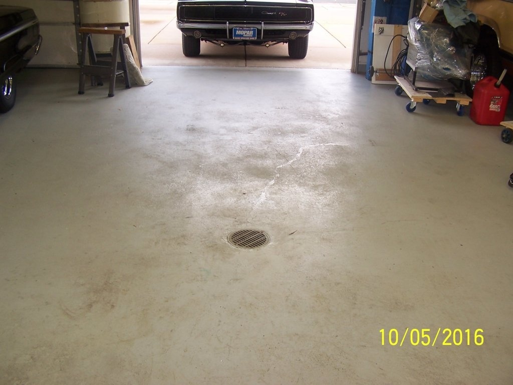

What should I do for floor drains? I've got several in my current shop and hate them, always getting creeper tires stuck, floor jacks breaking the covers, dropping bolts in them, etc. I keep a sqenueegee around and thought one in the center should do fine with a slight slope?

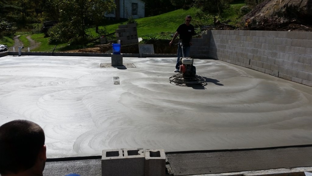

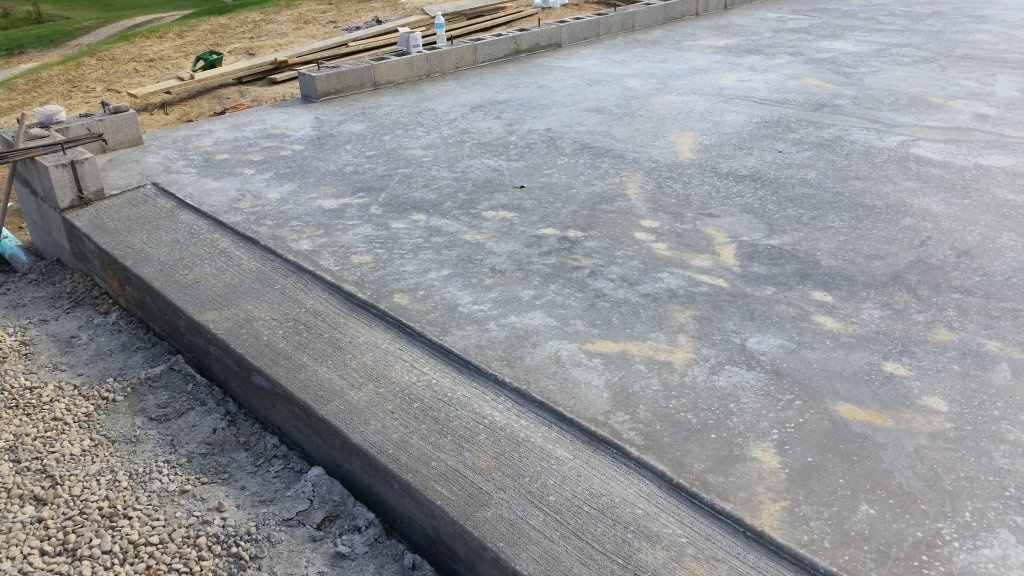

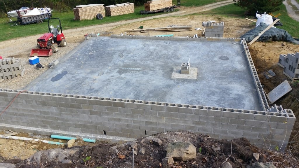

Looking really good now...there's a certain level of satisfaction in seeing a concrete floor go down nice like that....congrats.What an awesome day! If you remember earlier in the thread I gave a coworker my Dakota and in return he'd do the concrete, been stressing over how good he was.... not anymore. They (him, his brother and nephew) showed up 1/2 hr early and immediately started ripping some of my forms down, adjusting grade pins, setting chalk lines and moving things around which told me they knew exactly what they wanted. I love watching pros work, looked easy... but I know better. The floor turned out awesome, if I kick off on the creeper now I'll likely fly under the car and bash my head on the wall it's so smooth!
Finished the day off shooting guns, blowing up tanerite and some UTV trashing which ended in rolling it haha... roll bars work!.
I'll get a pic of the final product tomorrow, that pic is the first pass of trialing.
