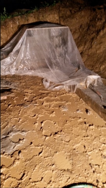

Here's a pic of my wonderful work conditions, I can't even express how glad I'll be to pour the floor!
YIKES!!!!!!! Maybe you need to look into renting a huge tent!

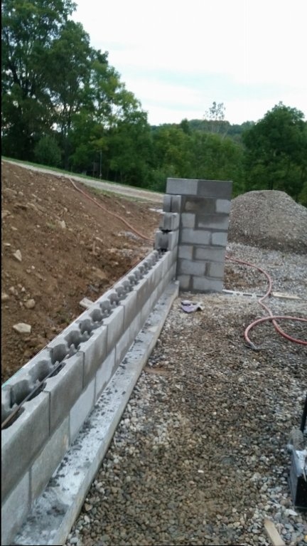

Man I was on a roll after getting home from the fair, laid 2 skids of block (110)! I'm liking these rebar blocks other than being harder to handle with the narrow web facing down giving little to grip on.

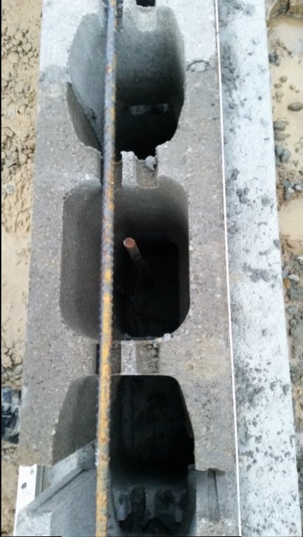

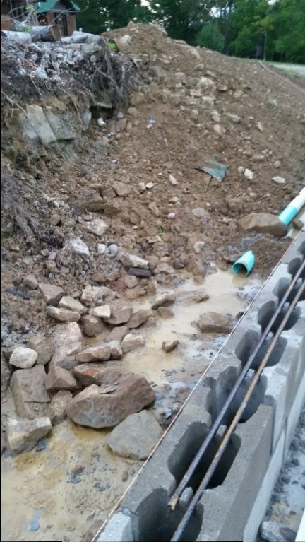

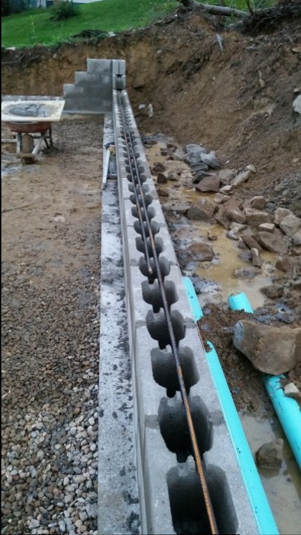

Here's some pics of the rebar block loaded with rebar and pinned to the footer. I'd prefer to put all the rebar to the inside of the block where it needs to be but they have to overlap so it makes sense to overlap them by putting one on the inside and one on the outside then alternate as you go up.
Man I was on a roll after getting home from the fair, laid 2 skids of block! I'm liking these rebar blocks other than being harder to handle with the narrow web facing down giving littleView attachment 363766 View attachment 363767 View attachment 363768 View attachment 363769 S,o far I'm fending off my back giving me fits by working smart, I mix a batch, dump it on a piece of plywood then set it on top of the wheelbarrow for a nice working height and lots of stretching.... herniate mmd discs suck!
Here's some pics of the rebar block loaded with rebar and pinned to the footer. I'd prefer to put all the rebar to the inside of the block but they have to overlap so it's makes sense to overlap them by putting one inside and one outside then alternate as you go up.
Looking good pal, nice block work! Been there done that, and have two t shirts.

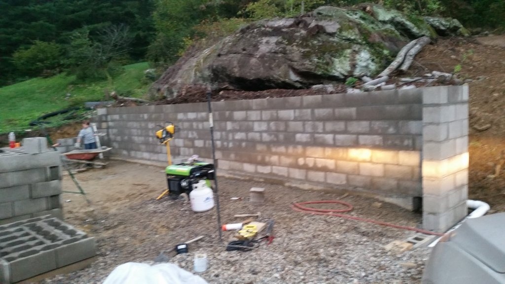

Back wall is done:thumbsup:. My boy decided to give it a try, not to bad for his first time.
