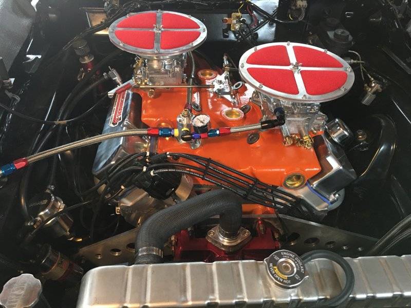

I'll add my data to this thread, hopefully someone can benefit from it. 505 cid, 270 Trick Flow heads, Trick Flow Max Wedge 4500 intake, good sized solid flat tappet, 13-1 compression and 1050 Dominator fueled... Runs 6.30's in the 1/8 in a 3550 lb Coronet, calculator says 9.80's in the 1/4 mile but I haven't ran to confirm.
nice combo very well done :thumbsup::thumbsup:

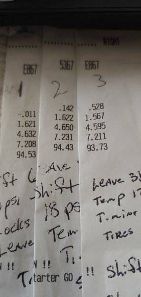

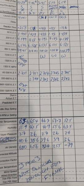

Here are Saturdays passes .
505ci TF270 heads . Pump gas. Street exhaust . Tbrake leaving @ 4000
This was a Kenda 660 1/8 mile radial event . It was Pro tree heads up (400 tree) 6.40 index class i raced . Chicago shoot out . I cant run 6.40s even if i ran off a cliff . Air and track were killer .
I took 3 wins but wasnt fast enough to make the final .
Weighed the Satellite @ 3790lbs race weight .
I think i am maxed out at the low 6.51s/10.20s
Tex

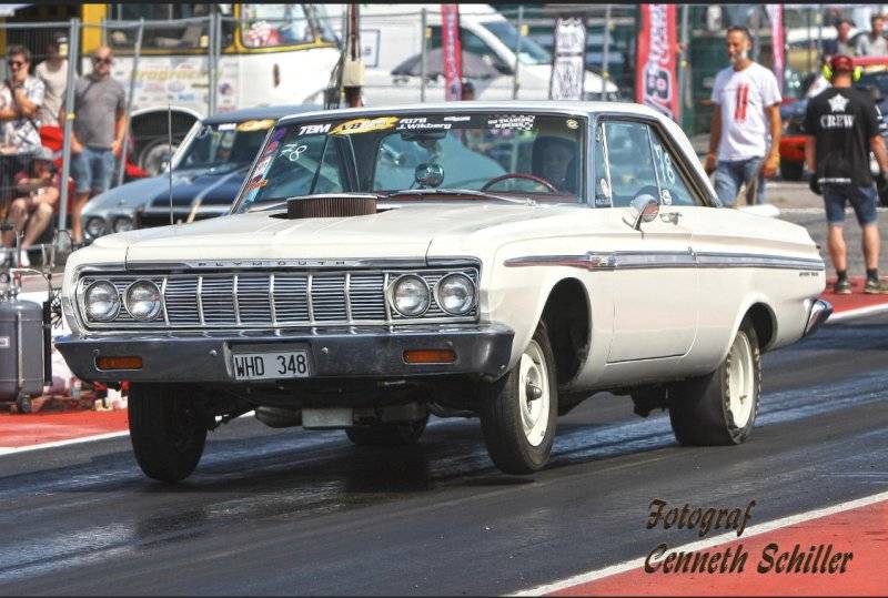

Made some passes a few weeks back. Best time 10.80@121mph and 60 foot at 1.51 in a 4000lbs steel body, stock interior 64 Sport Fury. Stock suspension except for SS leafs and calvert shocks.
Engine is a 440source stroker
TF240 heads
Tunnelram with dual 950 cfm brawler race carbs.
Cam is a Howard solid flattappet 260/[email protected] and 0.657/0.661 lift with 1.6 rockers.
29.5/9 Slicks
Picture is from last year with a single 950 carb and TF Intake and 26" tires
