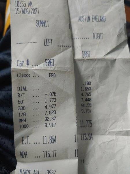

Yea 1st and second gear are like driving on ice without the tires being planted. My son took the video on FB, it might be his security settings.Wow, those are marginal for sure. At that trap speed I would expect 1.45 (or close to it) 60' times and 10.90's to 11.0's. Can you PM me a link to your video? It won't come up from your post.

I dropped around 120 lbs, and with the new carb got the AFR from mid to high 11s with the Demon to high 12s with the Dominator. The HF timing light was 4 degrees off, so my timing was 40 degrees, I found an old Mac timing light and have the timing at 36 now.
So basically I'm slower this year-
