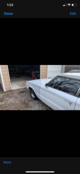

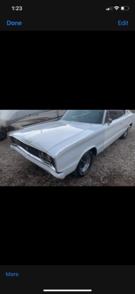

I am trying to avoid respraying the whole car. I have fender that is off white to the rest of the vehicle. Does anyone know of a paint shop they would recommend that i can ship my gas tank lid to so they can match the color? If they could ship me a quart of the paint? Thank you.
