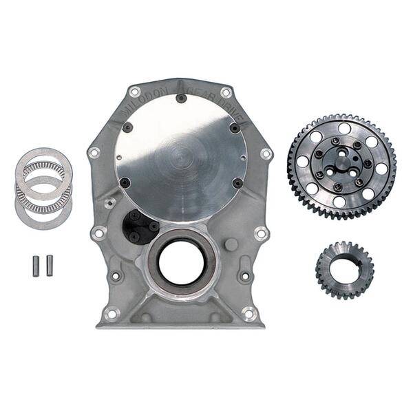

I run Milodon gear drives in all my stuff.
Worth the $$$$

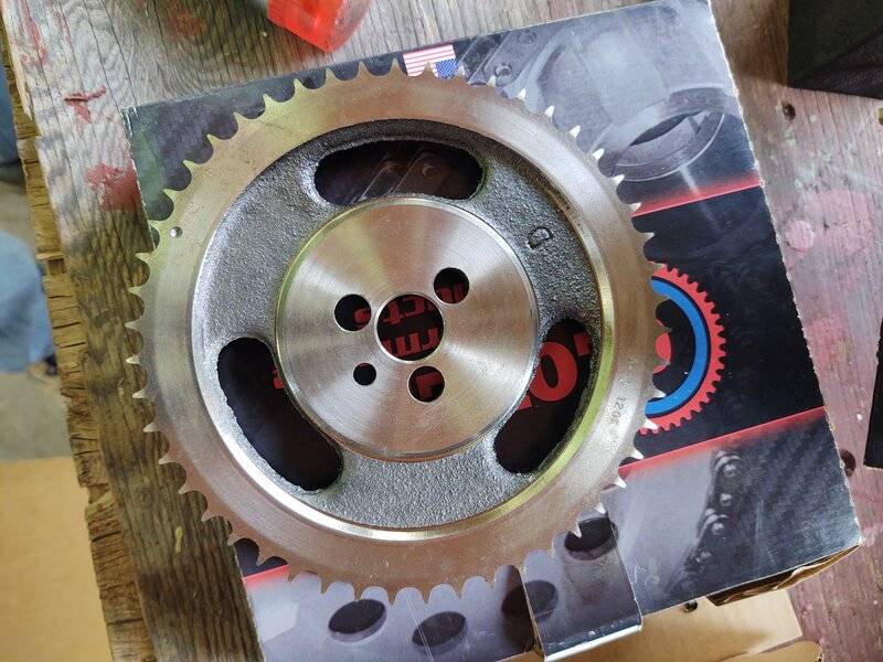

Here's a cloyes I bought several years ago just took it out.
What's wrong with this picture?
