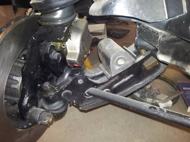

Have the 78 Charger big disc assemblies put on my 63 330 and the banjo bolts seem likely to hit the shock bolt area of the control arm!
Now this is at full droop and full lock but it still concerns me!
Did I do something wrong here? :confused4:
Am I being too fussy or is there an issue, and if so...how do I fix it!?!?

On my 66, there is a nipple or tang cast into the LBJ housing.
When turned to full lock, the LBJ nipple hits the LCA, preventing what you are describing.
This may actually be the "lock" that is refered to.
It's very close, like 1/8" gap, but it works.

Wondering...is the caliper usually mounted in front or in back with these swaps?
Ah, mine are in back to clear the swaybar.
That tang is right under your caliper, and the caliper probably stecks out more.
I'm 99% you can swap them L to R.
wait...is that the rear? show us the caliper side.
You have the wrong the cailpers. This is for rear mount calipers. This will solve your problem. I went through that a few years ago.
The calipers part # are Cardone 18-4144 and 18-4145.

Those Cardone calipers appear to be slider units...mine are pin units.
You're saying I need to change my brackets too so I can use these as no pin type will work???

Just found info... Looks like I needed calipers and hoses for a 70-72 B-body or a 70-74 E-body.
Thats the pin type with the different hole boss apparently.

My whole setup is from an 87 5th Ave. Sliders. It's close in that area but the tang hits first.
Try it and see what happens.
You want the maximum travel, so if there's only 1/8 inch, that's OK.
You may need different hoses. I'm using the part # for a 73 satellite or 78/79 Cordoba (it's the same).

Got the calipers...just over a $100.00 tax in (jobber price) and went to my buds shop for a quick and dirty trial fit.
The 78 Charger pads seem to fit the 72 calipers as do the slider bolts, the calipers seem to fit the 78 brackets and theres lots of clearance for the hose fittings.
Looks like I will have to relocate the frame mount for the flex hose but thats not a big deal.
The actual finish installation will tell the full tale...but it certainly appears everything will work now.
I'll up date this thread with the final verdict (good or bad) once this is completed down the road...

You are on top of it, the later B-body calipers hit at full lock. I believe 73 up are the ones to stay away from as I have a friend that pulled the disc brakes from a 73 roadrunner and ran into the same problem. As you stated we change his 70-72 B body or 70-74 E body calipers and he has no problems now. Good luck!
