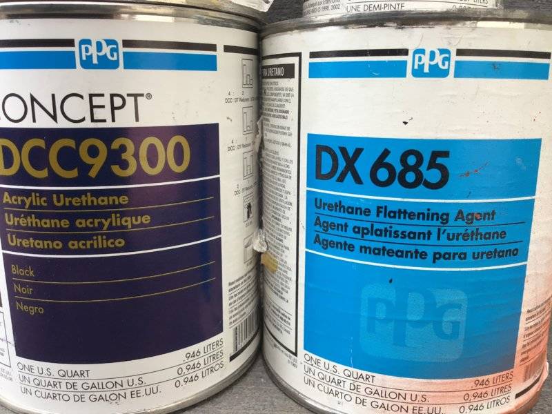

I'd use urethane with a flattening agent, around 25-30% flattener should be close...

I do like 1wild RT and use some flattener. If you don’t it’s way to glossy to look right, and it shows every speck of dust.
Go one step further and use a different amount of flattener for different pieces so they don’t all look the same. That’s more like the factory did it.

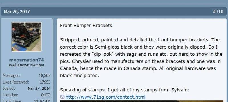

Weren't parts dipped, runs and and all. Does moparnation74's thread contain this info?

thanks Fran, i looked at that, i always reference Justins thread, im interested in what kind of semi-gloss did he use and degree of gloss... im liking what wild rt suggested.. thanks for responding

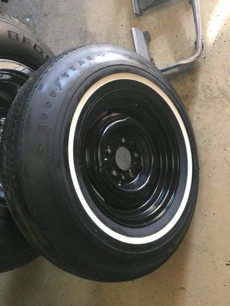

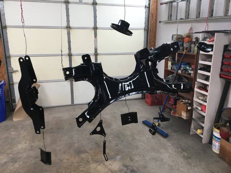

I use PPG Shopline acrylic enamel activated. I have a jobber here called BAPS. They have sprayouts of about 50 different sheens and products. Hanging pics are still wet but the wheel is obviously dry.
That wheel looks great. But why not go all the way with quality and buy urethane products? Why acrylic enamel? I don’t understand this using shop line and Omni products.

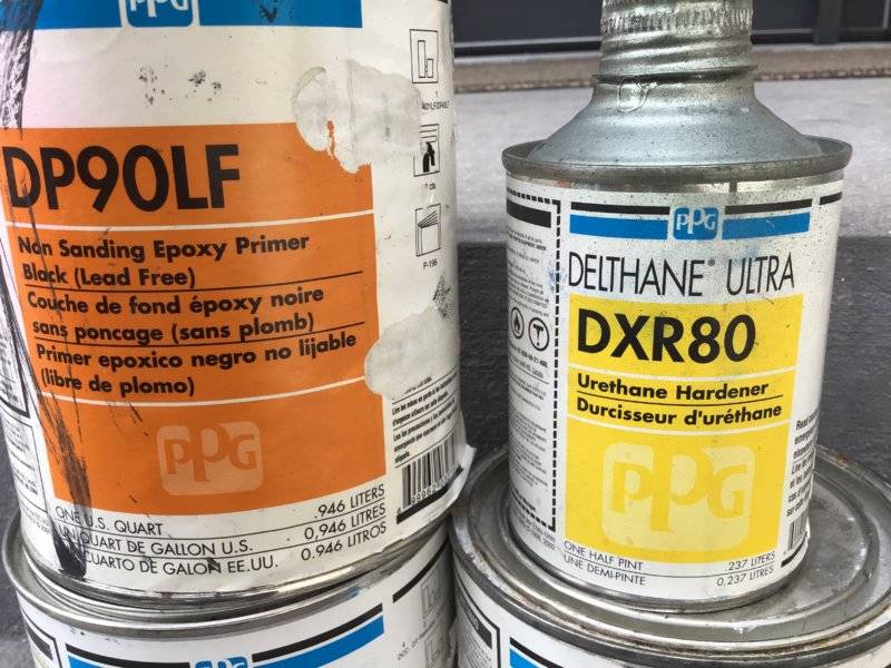

I used that for what I’ll call ‘everything’. The lore that I read here and other sites is that most parts were dipped in in the same bath. Sheen would change from factory to factory and vat of paint to vat of paint. This is where I decided to draw the line on cost I guess. Activated JEA for a car that gets <500 miles a year and is never outside is good from my POV. My parts were shot with epoxy first then this as top coat. My PPG rep friend told me, just because it costs more doesn’t mean it’s better when it comes to their lines.
