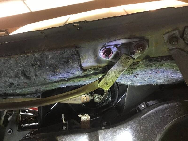

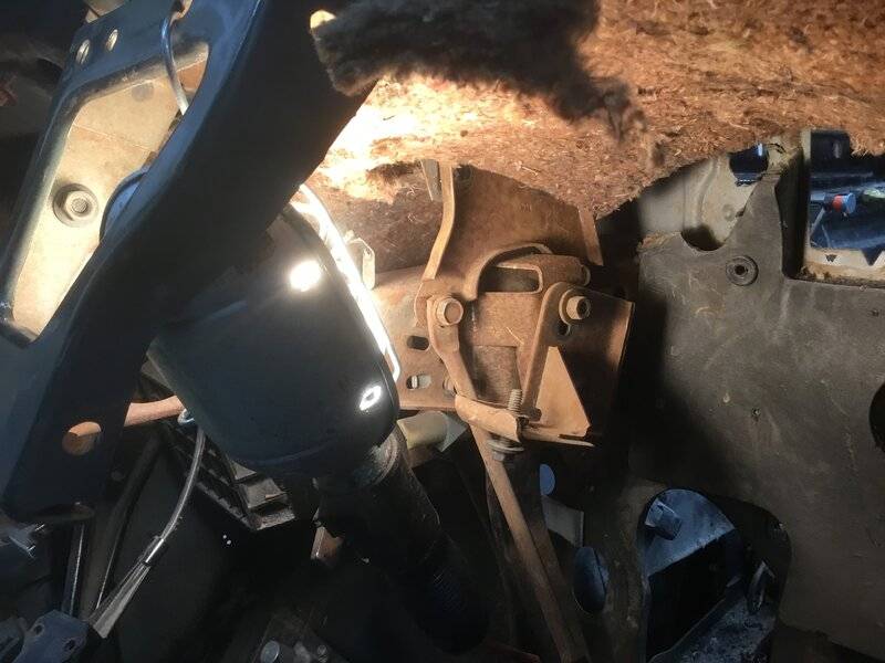

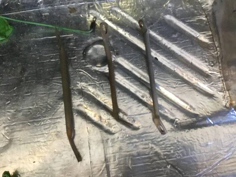

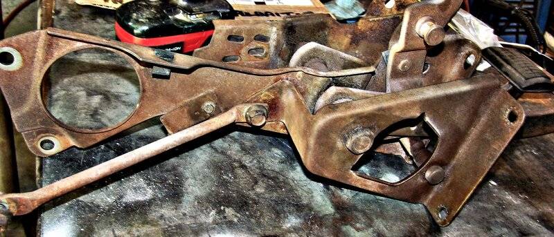

I didn’t take enough pictures of the rod placements. I appreciate it if some one could send me detailed pictures of where they go, or tell me where to look for information I would really appreciate it. I have looked a pictures on e bay
but not the same as mine.
Thanks

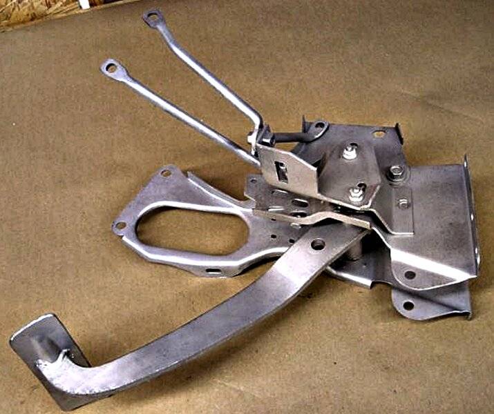

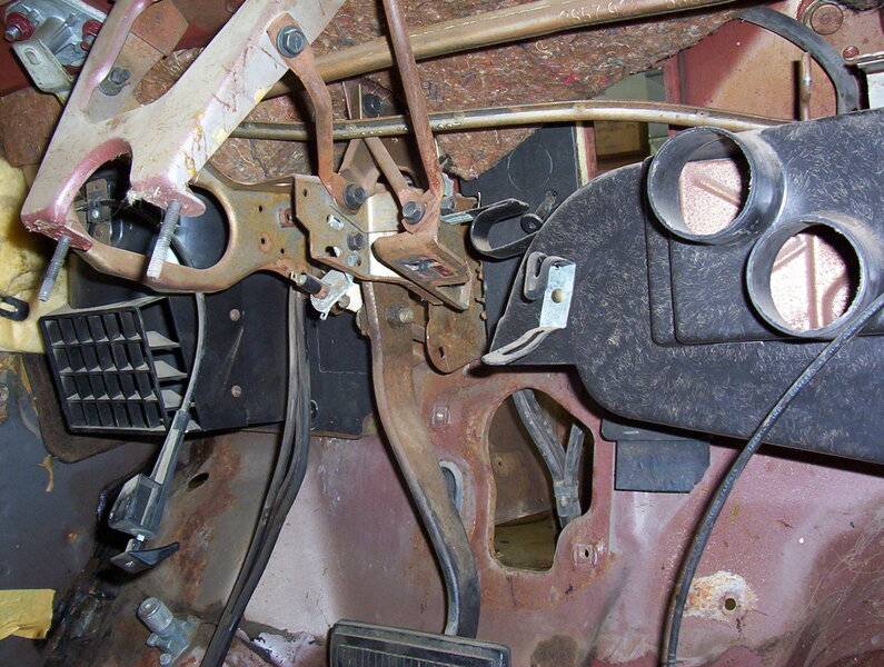

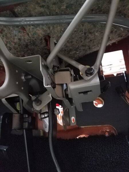

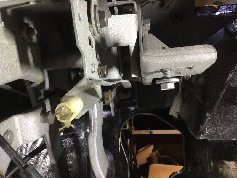

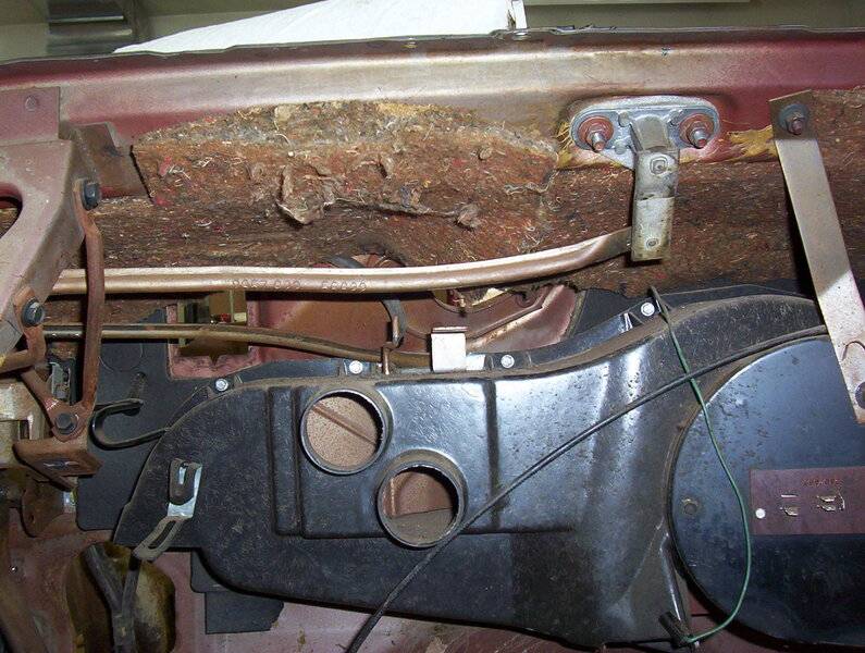

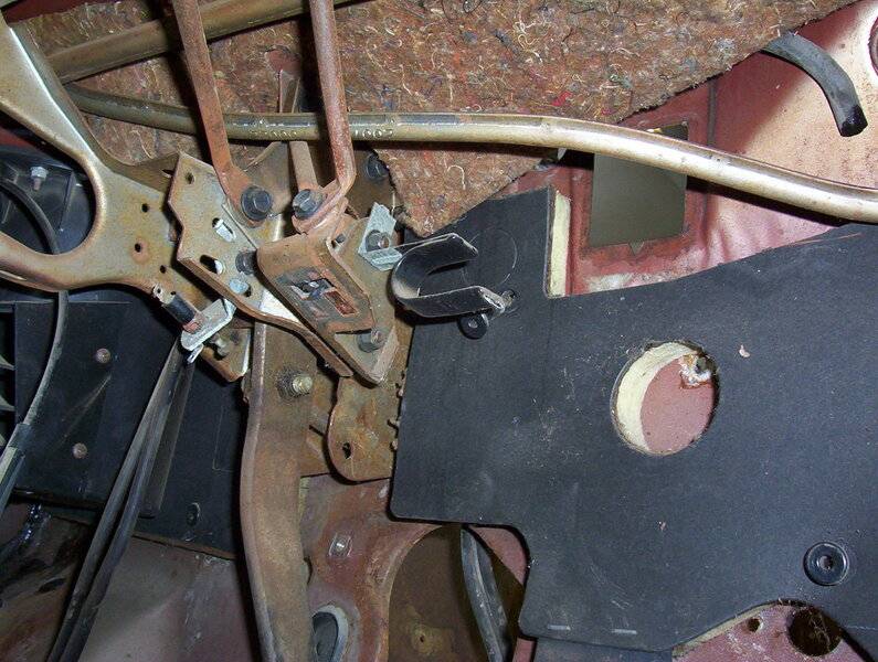

These are from my 69 charger. As far as I know the braces are the same manual or automatic.
Thanks, the dog leg one to the steering column should work. In my second picture I don’t have the same bracket to bolt my rods on. Looks like mine have to bolt from the bottom. Then to where?
I appreciate you doing this.

Are you sure you have the right brackets?

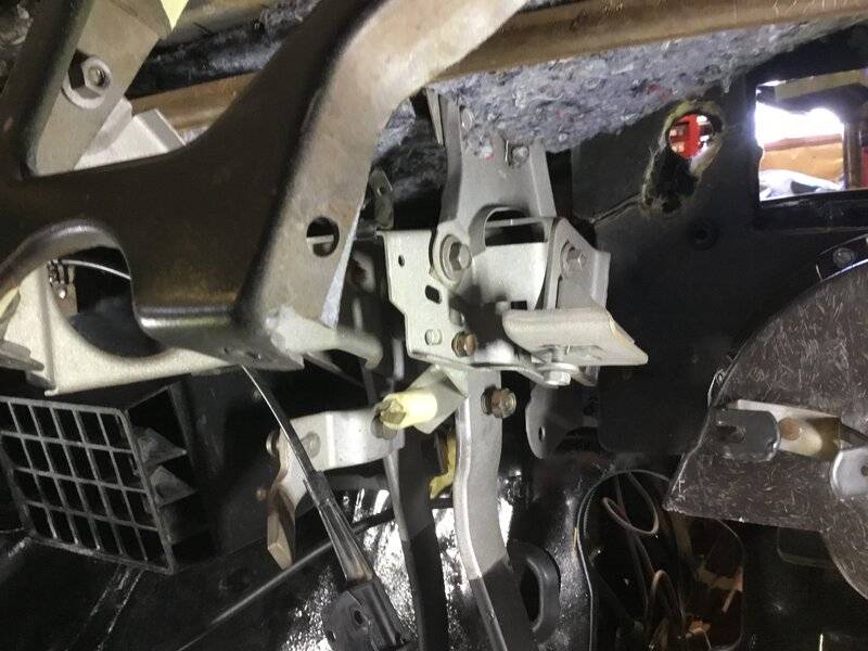

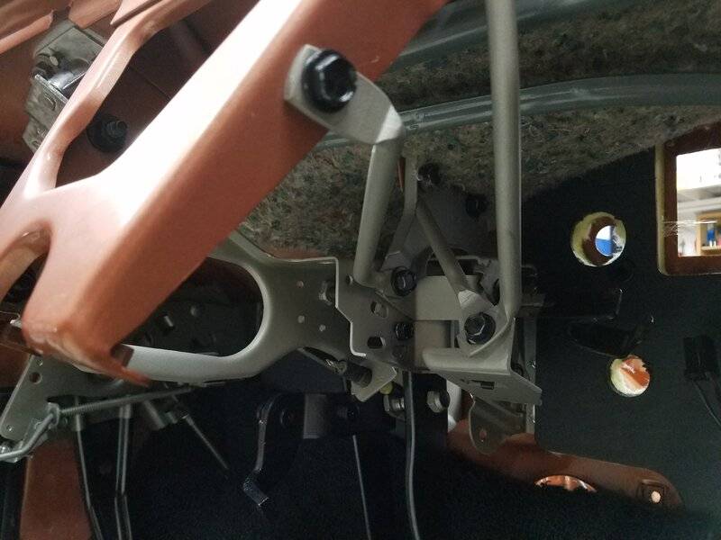

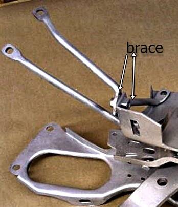

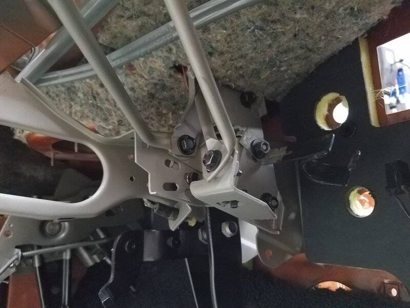

Here are some of my 69 Bee. Same as pnora posted above. I thought 67's had the same mounting setup as 69's?
The picture with the trouble light shows my bracket.
Definitely different than 68 and 69. Maybe try sending Jerry Hall a pm. He has several 66 and 67's.

My 69 Road Runner that I just restored had that long brace as well. It is the only car I have owned with that brace.
Yes it was a long brace going just above the left kick panel to the steering column bracket.

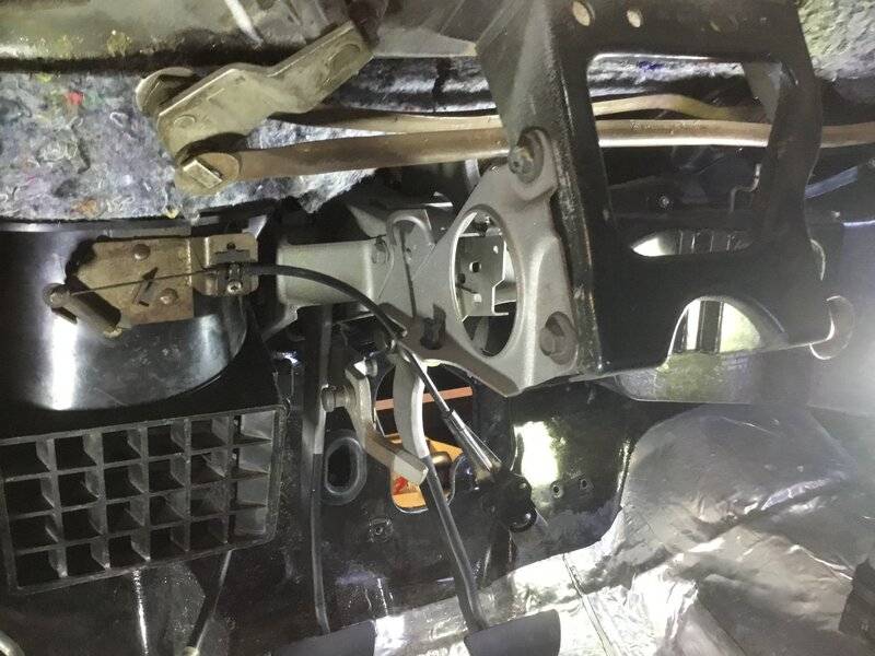

Thank you! If you look at my photo’s, my bracket does not have the L shaped bracket that your two rods bolt to on the vertical. Looks like I have to bolt mine from the bottom hole.

3ADC48C8-6A95-409A-8CDC-01B61196D92A.jpeg EC8A370B-F244-4ED5-A5E8-F4EA9E947DFB.jpeg
