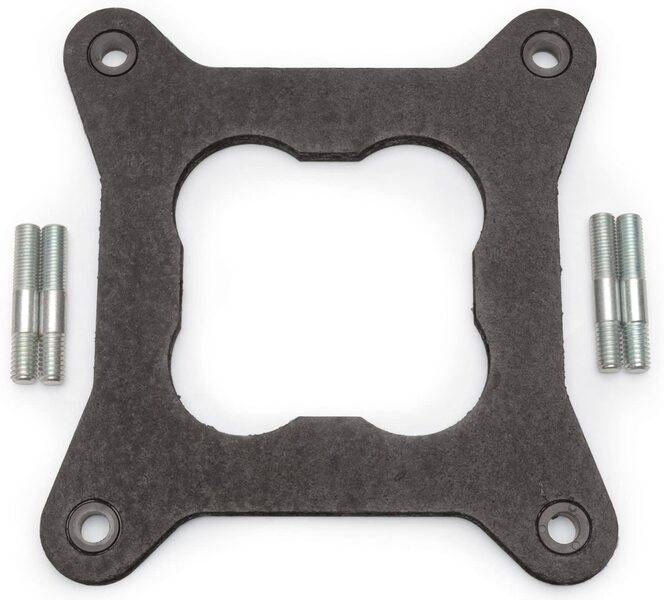

Its in 68 charger and it has stock unsilenced air cleaner and stock carburetor is carter 4401s. Will this work Edelbrock heat insulator 9265 and when car sit idled for 30 mins get carb hot because fuel evaporating in bowl with todays fuel

I know for 1970 / 1971 the factory Carter AVS used around a 1/4"- 5/16" base gasket with the factory heated choke well for the Carter AVS
And those insulated Edelbrock base gaskets work awesome
1968 / 1969 factory base gasket thickness ? I don’t know
Your choke rod will depend on it

I'm thinking I need heat insulator to prevent evaporation
So you mean I can't use heat insulator on this 68 383 intake because factory choke
Those Edelbrock heat insulator gaskets work awesome - I run one on my 71 BEE
They make an open and a divided version
But I don’t run any type of choke system
But like i mentioned earlier
Your adding about an 1/4" thickness to your base gasket , and that will change your choke rod geometry
It’s been a long long time since I played with a factory choke so hopefully someone else will chime in on the added height
