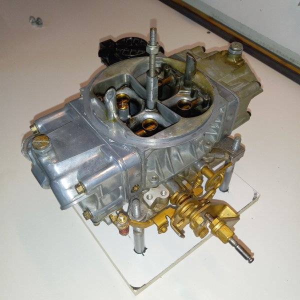

Even Holley carbs (from the factory) were plated and not painted.

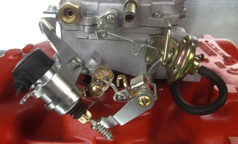

That looks a lot like the Eastwood carburetor paint they used to sell. - maybe still do. They also had a silver cad tone carb paint too. Can’t see how they could be very durable.

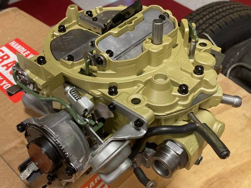

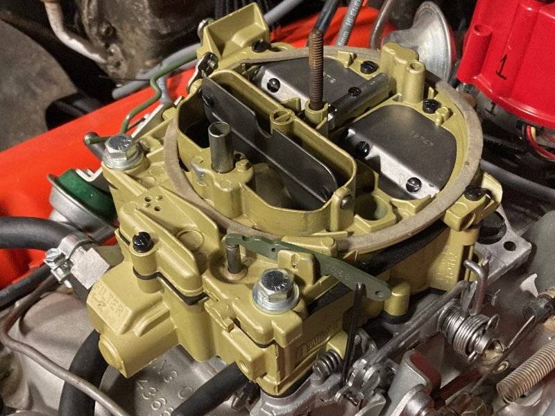

Here are few pics of my carb I did last year...as you can see the inside of the main body wasn't not painted ... everything else was 20211117_213959.jpg
Some of these (above pictured) painted carbs do indeed look very nice. And some restorations don't get driven much. So who's to say what will last and what will not?

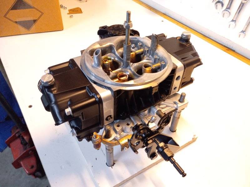

When cost and time are less an issue than making it look factory new, many things are possible. The restoration in this photo is one example.
