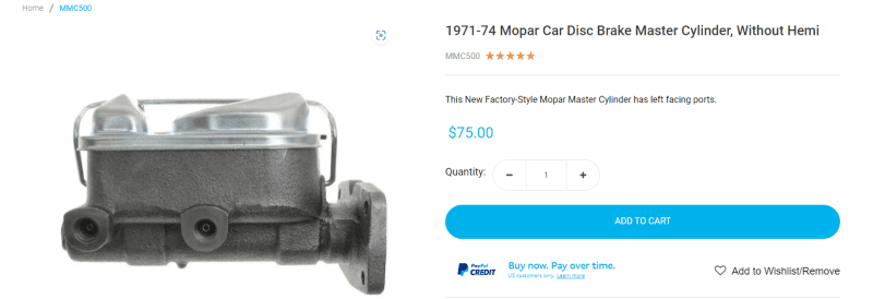

I would have to check to get that information. Everything is installed.
I just purchased one that was supposed to be stock equivalent.
Well it don't take long to remove four nuts, leave the lines connected, roll it forward off the studs & get a measurement... Generic 71-74 master probably a 1 1/8" bore... get a measurement off the original....

Checked the bore size. The new one is an 1 1/8". The old one is at a freinds house he measured 1" which doesn't seem right. I'll have to look closer over the weekend.
If you look at the original parts books from the 70's it lists a 1-1/32 bore master cylinder for a 70-71 E body... A 72 B body is the same platform with the same brakes... So I expect it would use the same bore size... 1-1/8 seems to be what all the current master cylinders are listed as...
Pascal's Law hasn't changed so why has the M/C bore?
Find a M/C with a smaller bore... Or get your old one back and put a seal kit in it..
