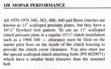

FWIW, When one mentions "11" flywheel" I relate that to the 143 tooth fly wheel, not the 130. Not interchangeable with the same bell due to physical diameter and starter boss locations.
Even some "scalloped 11" or "10.95" clutch sets, which fit the 130 tooth wheel, can be too tall for some older bells. So you should really determine exactly what you have presently.
Some on the "10.95" / scalloped" from MP....

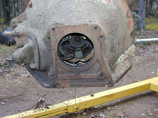

The 68-69 B/RB motors w/4speed used a 11” clutch w/143 tooth flywheel with a cast iron bell housing, part# 28922262 and 2892626.

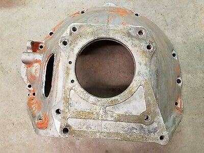

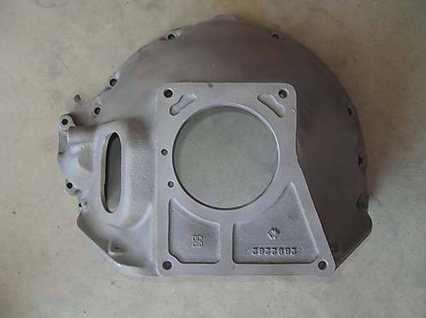

The “70-74 B/RB motors w/4speed used a 10.95 clutch w/130 tooth flywheel which is the same flywheel used for the 10.5 clutch. This was the aluminum bell housing, part# 2892513.
‘68 B/RB #2892262:
‘69 B/RB #2892626:
‘70-73 B/RB #2892513.
