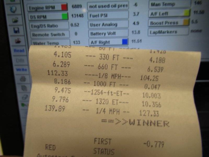

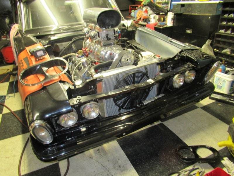

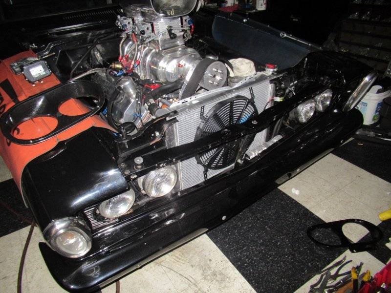

I used a $200 Afco 3 pass aluminum radiator with a single 16 inch Spal puller fan.My blown HEMI does not go over 190 on a 90* day.No shroud either. 1st I tried dual fans,but they would not fit.......

Afco aluminum radiator$200
Spal 16 inch pusher $135
Unless it's hot out I don't need the fan,,,,,,,,

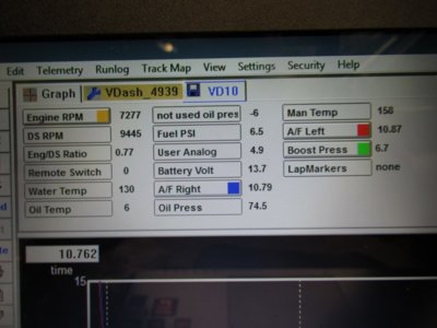

Al, that blower is a giant heat sink that helps to keep that hemi cooler...I’ve experienced the same on other blown motors with iffy cooling capacity.
Manuel temp sensor is intake air temp.Not even 7 lbs of boost at that rpm.Could be leaned out as well! But i must say the Spal fan blows so much air through the rad it will blow a match out on the water pump!! Moves alotta air.
And the black grill is history,didn't like it!
