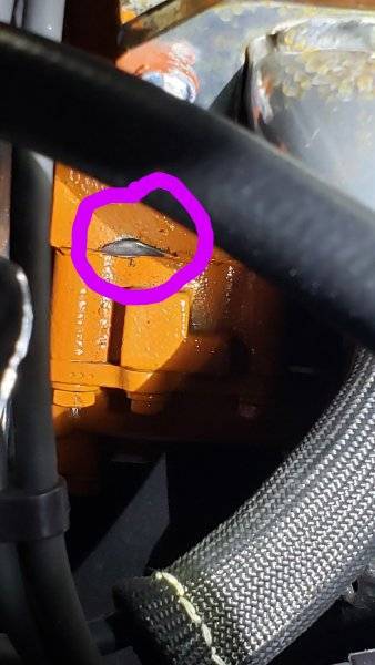

That's the O ring that may be missing. Also I notice RTV squeeze out ? ...... going to remove the pump and have a look, Most likely put a new stock one in. Don't need high pressure or volume. I put a windage tray in my road runner and have never had an issue.... but no gauge

There really shouldn't be any sealer used around the oil pump anywhere. Remove the pump and carefully inspect the ports in the block as they may be full of silicone. The delay in oil pressure at start up is not normal to me. I get 40 PSI when cranking my engine before it starts then 70 when it starts cold.

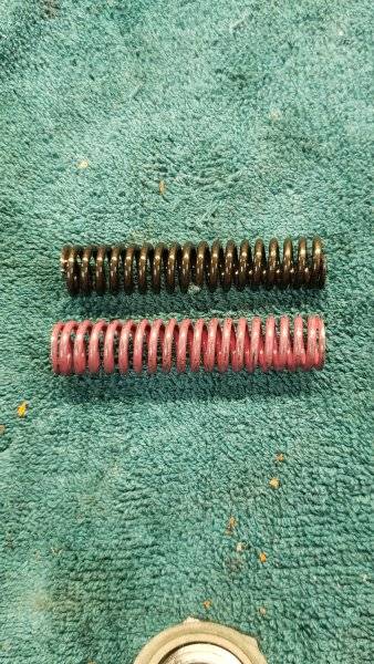

Pulled the pump on the Coronet and this is what I found. Looks like the filter to engine port is about 50% if not more covered with RTV. The builder went wild with the stuff? The "O" ring is intact. When you bolt this up that port will really close up. This stuff is like rubber. The pump is clean inside.
Would this cause Oil pressure delay on cold startup? Also starvation under hard acceleration? and fast fluctuation when shifting.... I think so? Also look the relief springs, the top came out of the engine the bottom is off the new pump. I'm going to ask the builder what kind of pump he put in because it's not on the paperwork.
