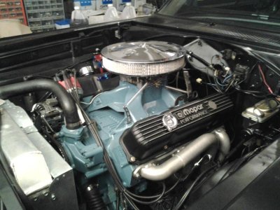

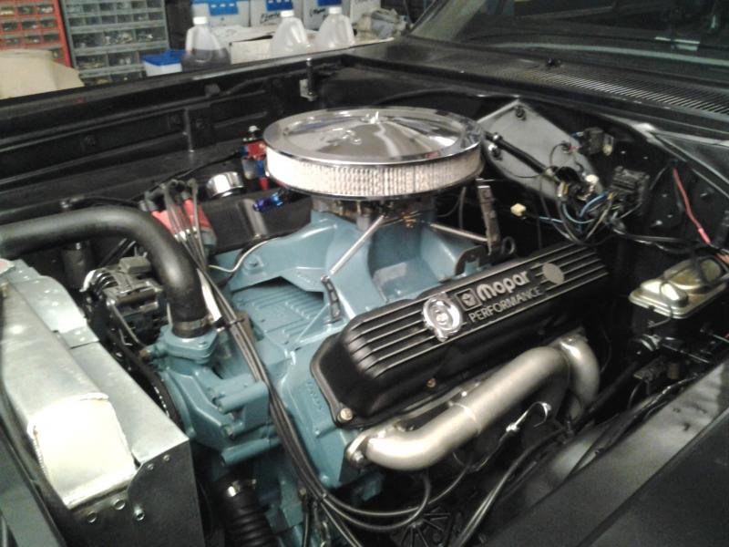

I have the TTI Step headers on my 66 satellite and they work great easy to install ...
