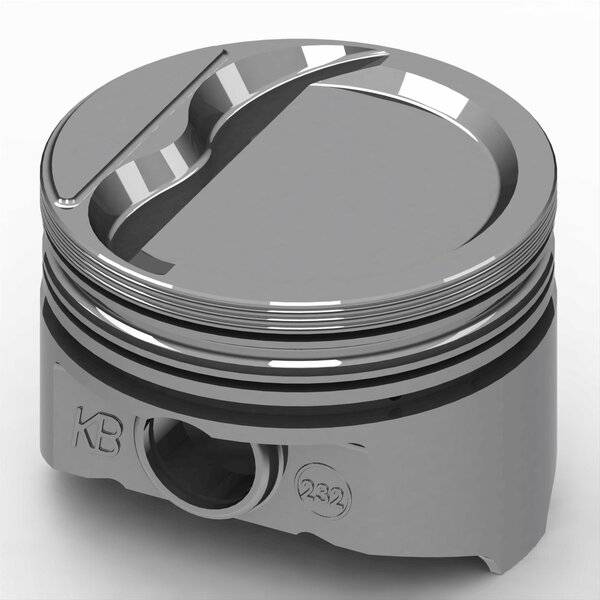

I think you mis-read type of piston? Not a Dome piston for compression, but a "quench dome" piston which is more for resistance to detonation than to raise compression. I built my 360 LA engine with the KB-232 pistons. Really designed for the Magnum 360, but these pistons have 0.050" raised "Quench Dome" to fill the void of the stock open chamber heads, even though the pistons are a 18cc Dish design.

The open chambered heads need a bit of dome to fill the void. The on line calculators will help with the math to find out what the new ratio will be.
