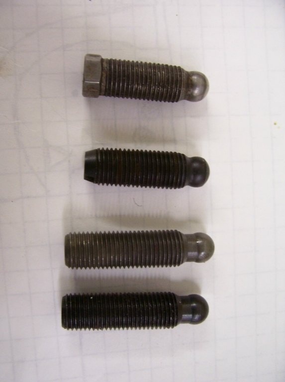

i strongly recommend no threads showing on the newer adjusters, and no more than one or two showing on the earlier adjusters. no threads showing will give better push rod geometry and parts will last longer
Interesting, do you mean no threads under the rocker? I may have mis-interpreted the question. I shot for no more than 2 or 3 threads under the rocker tip.
Not to derail the thread but how much oiling happens at the valve train with iron rockers? Mine just have a trickle but everything seems happy.
quoting the engine manual, "the rocker adjusting screw is to have only one thread showing below the rocker arm with the valve lash set properly (two may be okay, three shaky, etc)". i think the newer longer adjusters are more problematic. the ball is extended from the threaded section an additional .100", equal to 2 1/2 threads. add a couple of turns and smoked push rods or broken adjusters. definitely no turns for the new stuff.

using shims to compensate for long push rods or milled heads will probably screw up the geometry. you'll find that the RPM heads will need a custom length push rod and possible rocker shaft shimming to get proper geometry. don't have any threads showing if you use the latter long adjusters.
