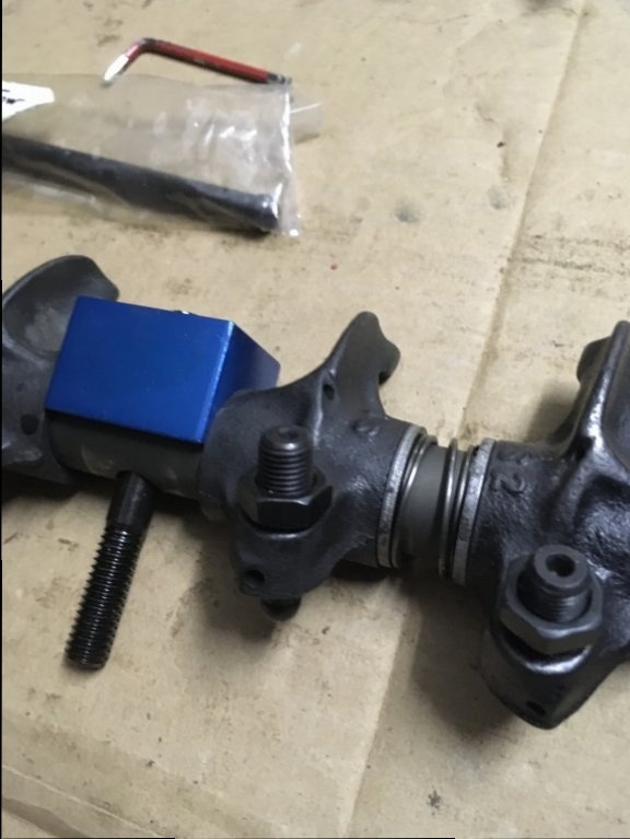

Here's the pics of the rockers, no idea of the brand, the are moulded
Fkn phone.
The are moulded with s1 and s2 if that helps. New adjusters as well.

Just curious, lewtot184, those adjusters pictured, are those solid? Or, have a oiling port at the ball? Lol...or just require hollow pushrods?

no oiling orifice. oil has to drip down the back of the rocker into the cup. with too many threads showing the cup doesn't oil as well.

i prefer the slotted adjusters with the iron rockers because the ball is closer to the threaded section. this helps geometry and if by chance too many threads are showing your more likely to get by with it.

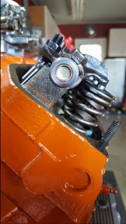

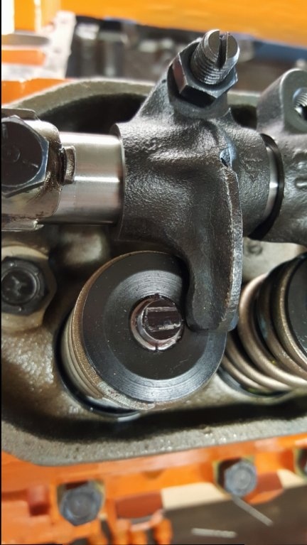

I checked the sweep of the rocker over the valve end, coloring it with a marker, then rotating the engine through one cycle to see what pattern the rocker left. I did this on several rockers. It's also a good time to watch for the spring retainer to rocker clearance and pushrod through the head clearance.

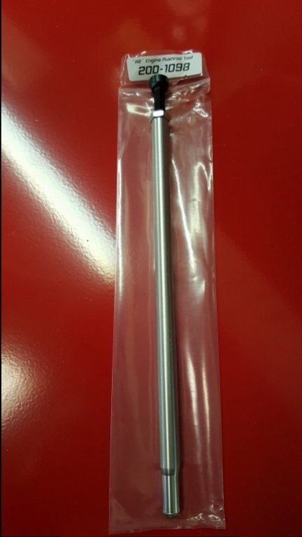

Buying a pushrod checking tool is a must. This one held up fine, using it for rotating the assembly while checking for clearances. (You can buy a lighter, valve spring for doing this.) Also I made a "solid" lifter for doing this operation. After I was satisfied with the length that the rod was set to, I ordered that length pushrod.

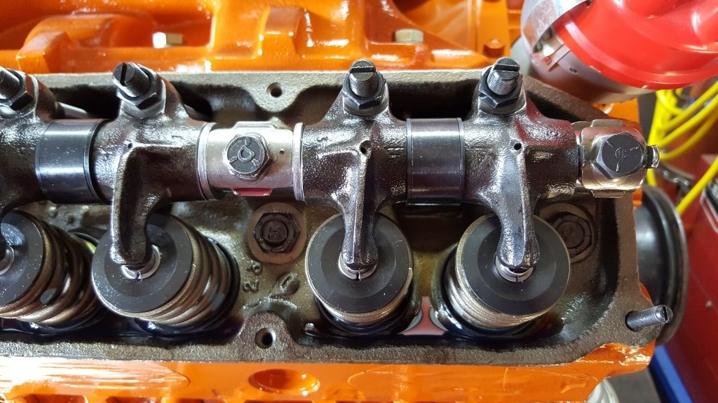

And then there is the centering of the rockers.
The Crane rockers that I have were not uniform to each other. I had to evaluate the ones that were off a bit and place them where they would work better than the others. I bought spacers and shims to use and removed material on the hold downs. Pushrod through the head clearance came into play here too. More fun but they worked out fairly well.

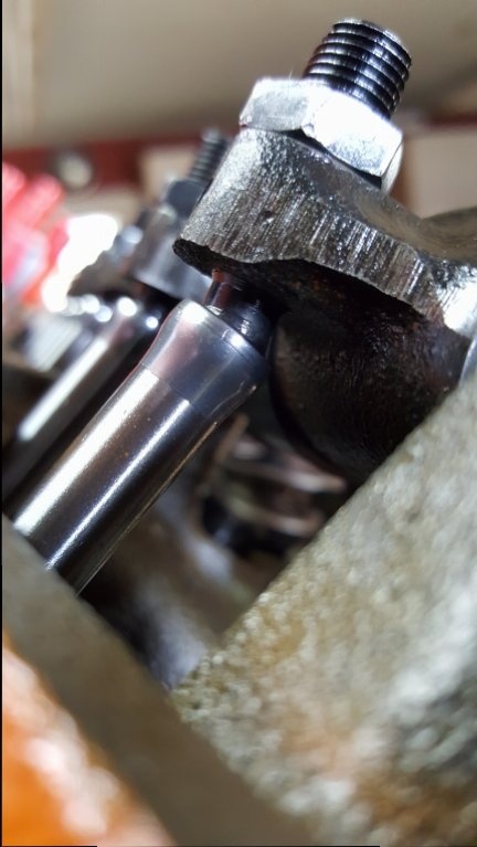

push rod/adjuster looks good. paying attention to details, like you did, will pay off in the long term. good pics!
Right....setting up a valve train isn't a plug and play issue....or bolt and go especially when it's aftermarket stuff. Even stock stuff should be looked at carefully. The factory wasn't exactly on the money all the time. This is the reason why I degree in EVERY cam I install....stock or performance.

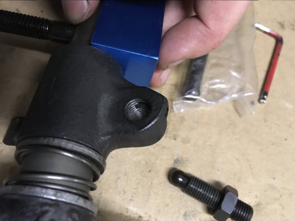

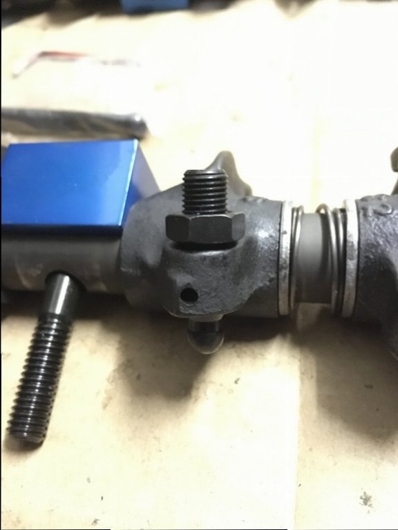

Only thing I'm off on is the oil passage to the adjusters seams to come out at least a few threads up the adjuster female threaded section. Is any oil actually going to get there that if its screwed down even / 1 thread showing? or will it seep past the threads onto the ball and into the cup?
On a side note I would have much preferred the slotted adjusters, the threads were tight form the PO's use and I threaded the hex hole on one of the adjusters cleaning them up. I'll get in a replacement, but the tiny 1/8 hex holes just can't take very much torque through them at all.
One set of used ductile rockers I have, had the self locking threaded adjuster, (no lock nut) The thread pitch is off just enough to keep them from turning. And they are hard to turn.
Do you have the lock nuts on yours?

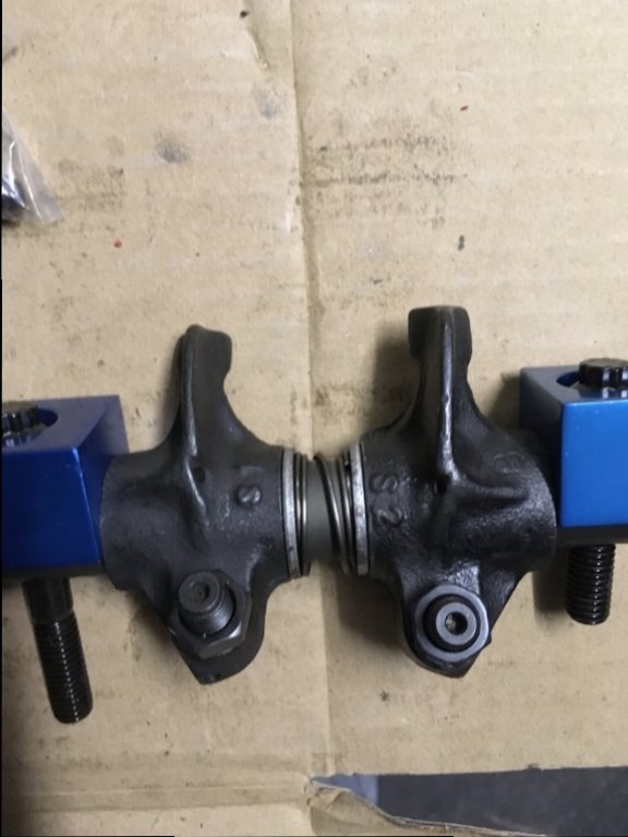

The oil passage goes around the adjuster. Remove the adjuster and look in the hole. It can not be blocked by the position of the adjuster.
Nah mine have the locking nut, but the previous adjusters might have had the tapered threads. They didn't have the locking nuts. Another user on here thought they were from a slant 6? They were in bloody tight.
RE the oil passage, here is the pic of the oil passage in mine. it looks as though it can be block? Is that fine? or are mine different?
