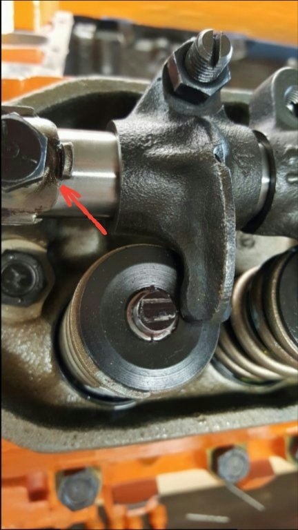

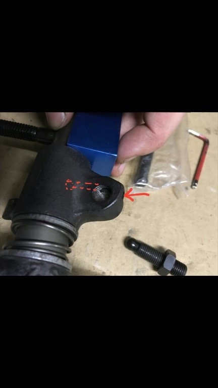

The oil passage was drilled right through into the section that mounts on the shaft. With the adjuster installed there is still plenty of room around it.
