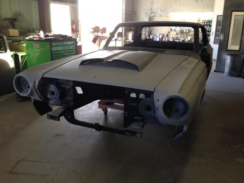

Add a scoop like this:
(My 63 Max Wedge clone)
