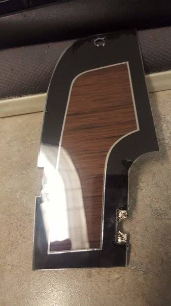

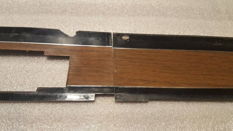

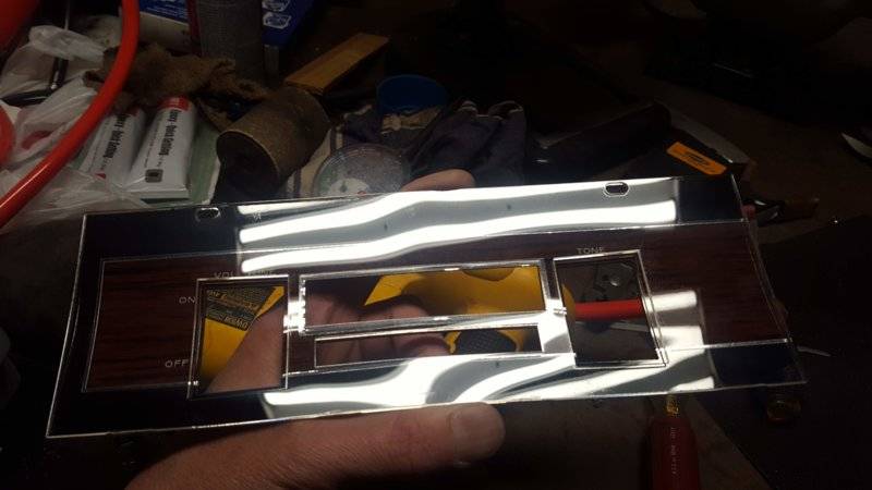

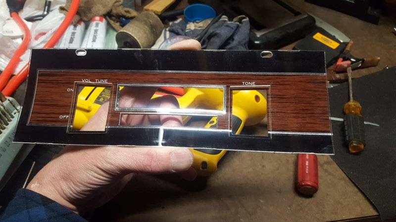

I tried to reproduce the black vertical appearance in Photoshop but was unsuccessful. Maybe later in the year I'll work on it again. If anyone here is good at Photoshop please contact me.

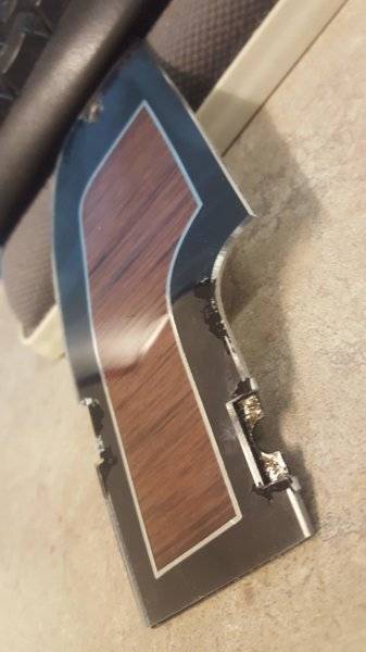

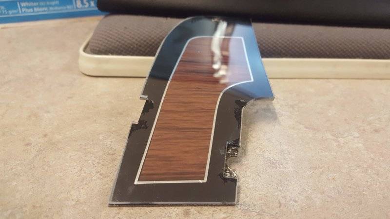

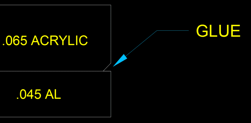

I still think a clear coat application might be the ticket.UPDATE! Here's the latest...hopefully this journey is nearing the end...I just need to figure a good way to adhere the acrylic to the aluminum...
This thin cyanoacrylate wicks in from the edge too deep. Perhaps a thicker adhesive would work better.
I'm open to all ideas.
View attachment 721234 View attachment 721235 View attachment 721236 View attachment 721237 View attachment 721238 View attachment 721240

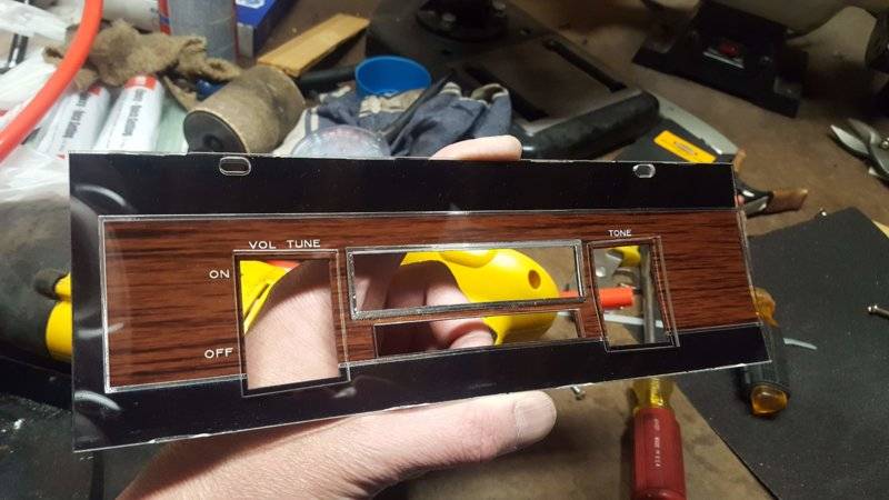

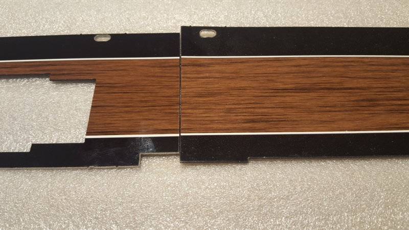

I built a push button radio bezel with the acrylic over aluminum method. Although it's just a prototype and there are a couple of imperfections in it, it looks impressive. (video attached...)
