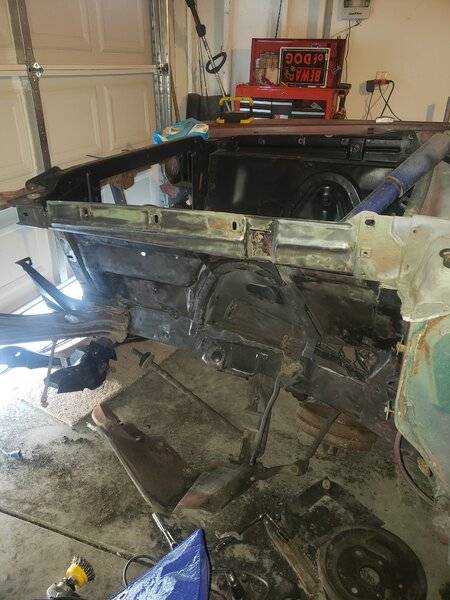

Yesterday i removed my fenders to make my wheel wells look nice and took it bare metal, (regretting doing that now ). Now i need to paint the metal and wanted some opinions. Ive never done any painting but just purchased a gun. Should i use an epoxy primer, chassis primer, rust encapsulater, looking at the eastwood site , there is too many options.
Thanks in advance

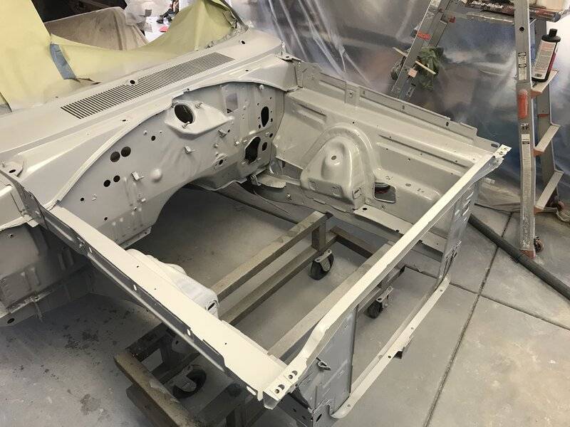

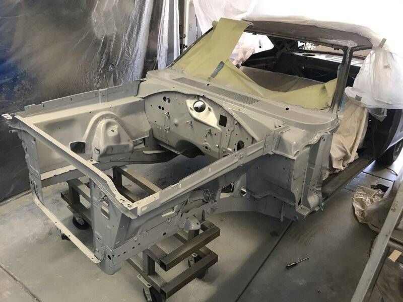

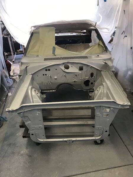

Well here’s my two cents. I literally just finished painting the entire front end of my car. Mine was down to bare metal from being media blasted. I basically sprayed it with phosphoric acid to remove any oil and contaminants and also etch the metal. Then I used a primer called Vibrance. From what I understand some Apoxsee primer’s can be very difficult to sand. The more expensive ones are actually made with better chemicals and are much easier to sand. Mine has been extremely easy to block and knock down with sandpaper.
it’s a direct to metal primer. Just put it in my gun and shot it on.
