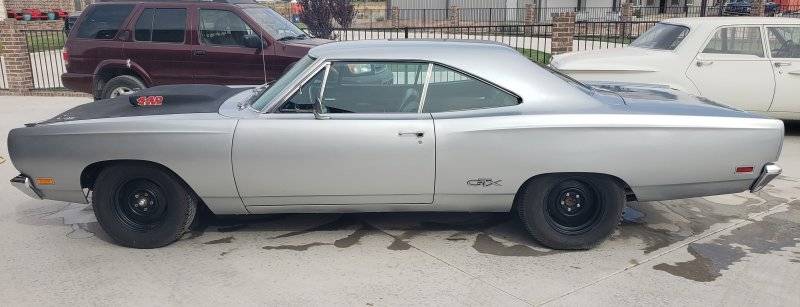

I've never legally raced my GTX but there is a strip just north of here. I bought a helmet, installed better lap belts and mounted up some new MT Street E/T tires in 275/60R15. I think it's an 1/8 mile track. I already have a driveshaft loop installed, fire extinguisher inside. No idea as far as times but I'll post results.
Sweet car. I hope it hauls ***.

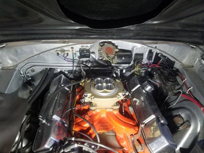

As for the car, 440 bored .040 over, .008 quench, 10.2:1, stock stroke, Hughes STL3842 solid lifters cam, Hughes rockers, cnc ported Stealth heads, Sniper EFI on a Holley Street Dominator intake, 1 7/8" headers, dual exhaust, crossover.
727 trans rebuilt with billet servos, Transgo 2 shift kit, PTC 8 1/2" converter from John Cope, Alum driveshaft, 8 3/4 rear 3.55 Eaton Trutrac.

sounds like a cool combo
as long as it stays slower than (don't remeber 1/8th mile rules break point)
(*11.50 or 12.50, or *150mp @ 1/4 mile maybe devide by 1.57)
snell rated helmet (should wear one anyway),
*rollbar min., *full harness, *fire-jacket etc.
maybe (?) not 100% sure on 1/8th mile anymore
*7.30 (95+mph) & 8.0 in the 1/8th mile IIRC
(don't quote me on that)
are where the different safety equipment levels starts to kick in
you're probably safe
IMO 3.55:1 gears may be the only hold back from
'doing really well'
on a N/A combo in the 1/8th mile, generally need more gear
make a good ET, make up a lot in the 1st 60'-330', where time is precious
maybe play with air pressures on the rear tires, may help hook too
somewhere between 14psi & 20psi, depending on tires & sidewall etc.
very respectable 1/8 mile #s, for a street/strip car
you may get as low as 10's (or high 9's) in the 1/8th, maybe better
it is a heavy car
I wouldn't do big long smokey burnouts,
Drag Radials In my experience
just seem to ball up & don't hook if they get 'too hot',
just get them to smoke 2nd or 3rd gear
(don't stay in 1st long)
& let off the brake, then roll out to dry area
"But" don't let it dead hook after the burnout
(caution it could be bad on the sprag/overrunning clutch,
not sure if you have a pinned or bolt in style
anyhow,
no matter what it runs, enjoy the time
good luck & have fun,
that's what it's all about
get someone to video it for you too
I'd love to see it...

sweet car! Have fun and post some results.

very nice looking car.
