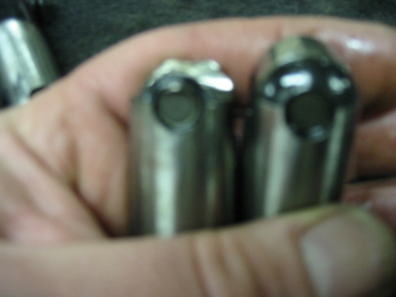

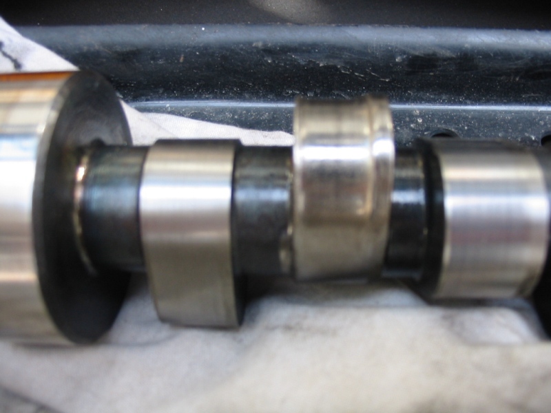

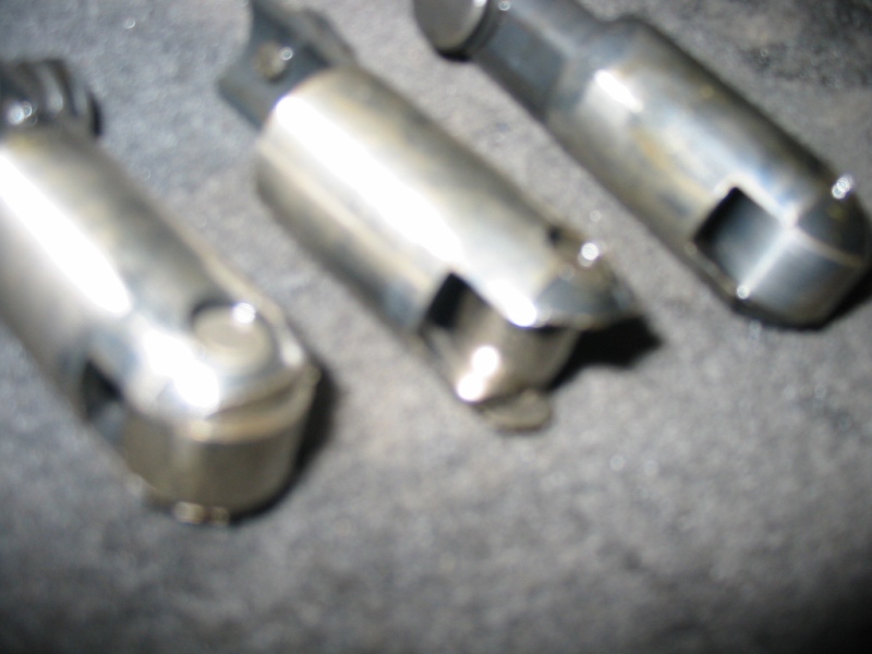

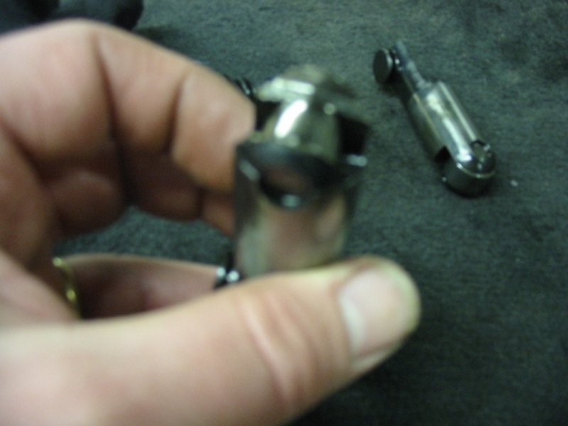

Since I had my valley pan out I took some pics of the solid rollers on the hydraulic cam to see what the wear looked like, me not being any kind of expert would like you guys to look at the pics and see if you see any unusual wear or damage. up close you can see visible surface wear on the cam lobes, the rollers feel fine rods look ok to me nothing bent at first glance.
Let me know your thoughts does this look like it is going down anytime soon?

The lifters need to come out and the bearings checked.A flat tappet cam is cut on a taper to spin solid lifters.This will put additional side load on the lifters,causing premature roller wear and tapering of the roller.Its hard to tell from the picture.Looks to be some grooving or scoring in picture #2.Also check lifter bodies for scoring pic#3.

Look at pic#1Look at the lifter to cam lobe.Could be just the pic.It looks as the lifter is over the edge of the cam lobe.This will cause the what looks like a groove in the roller.I see it again in pic#2
Pic#3 and 4 it maybe just the pics.Look at the lifter bodies.
Solid roller cams are usually harder in material and carry more agressive cam profiles.If the valve springs were matched to the hydraulic cam shouldn't be a problem.If spring pressure is to high it will cause the lifter to dig into the cam.Same thing can happen if the lash is to loose.

Yes I remember your pics that is what prompted this thread, wanted to see just how how bad the surface scoring is from other perspectives. Up close the marks on the lobe's are just surface can not feel any grove. wondering just how long it's going to last though.
There are around 600 miles on it. The spring pressure is what ever they made the stealth heads with I don't know. They were not take out but the few that were off the lobe i was able to spin freely. Since they are solid we have lashed them a couple of times with the final being at 8/10.
However for those who know about my adventures with these they were originally thought to be hydro lifters and the lash was set for that, once we figured it out instead of changing them we kept them in and made the correct lash adjustments. So for the first maybe 50 miles they were lashed wrong. I.E. 1/4 past lash pre load.
You figure about 50 miles??That might account for some of the skid marks on the rollers.Being that tight,at times the roller was skiddin' not rollin':eek::violent-smiley-100:
What really saved you were the light springs.If they were the correct springs for the setup.It would have wiped out a few parts.
If the lobes feel smooth and are straight,meaning no dishing in the wear marks.You should be ok.You should check your end play also.The edges of the rollers have no pits or chips.The rollers are smooth with no play in them.The bodies of the lifters are smooth.They should be alright.
As Hemi-Itis said if you are chasing a lifter or lifters as for adjustment you have a problem.
You really have some mismatched parts.The springs are really to light for a roller application.Take it easy with it.Until you can get all the correct puzzle pieces to make it right.
