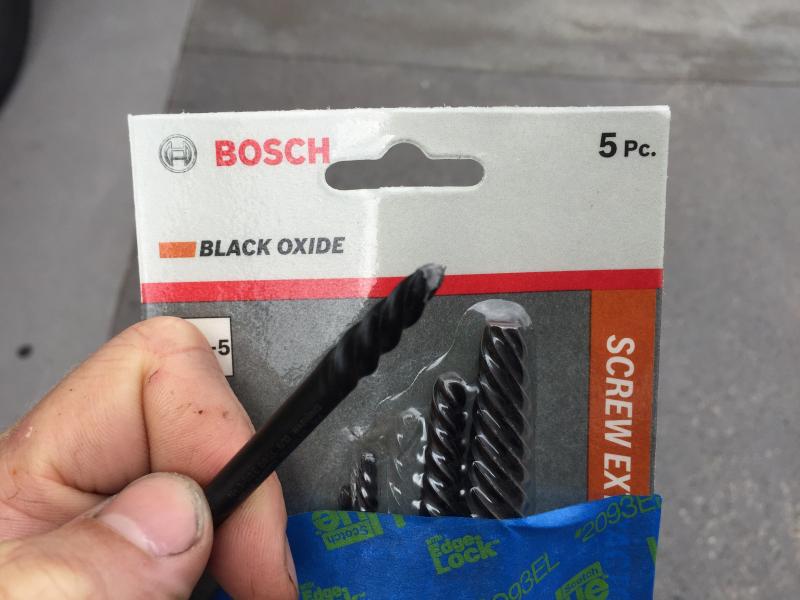

Here's the broken stud remover: FYI don't but bosch. Junk.
