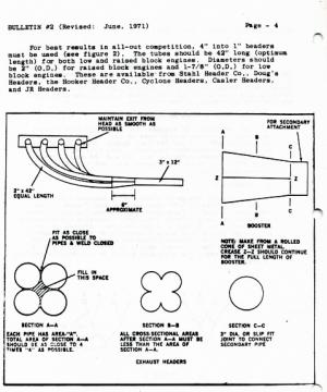

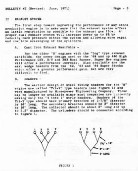

check out these specs..this might be useful
