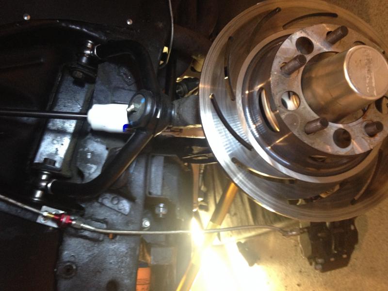

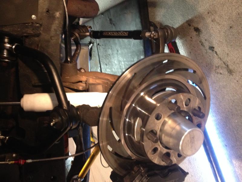

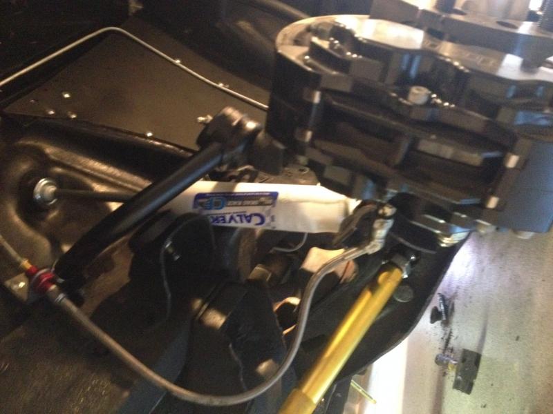

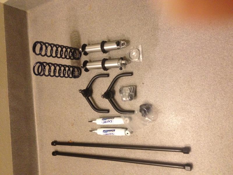

Just finished up my winter suspension project. Some of the parts used smaller bars Firm Feel, Strange double adjustable shocks coil overs Riely motorsports A arms, Calvert 90/10 front shocks new tie rods and bushings, existing Strange disc brakes all four wheels, corner balanced, IMG_0389.jpgIMG_0392.jpgIMG_0393.jpgIMG_0394.jpg
Canyon what size bars did you go to?
Just finished up my winter suspension project. Some of the parts used smaller bars Firm Feel, Strange double adjustable shocks coil overs Riely motorsports A arms, Calvert 90/10 front shocks new tie rods and bushings, existing Strange disc brakes all four wheels, corner balanced, View attachment 301746View attachment 301747View attachment 301748View attachment 301749
Nice set up. Do you prefer the O Riely motorsports A arms over the QA1's stuff. How do you think the rod ends would hold up over time?

Well all I can say so far is this is it. Re corner balance next week and then try it out. It really needed attention and all these parts came from good sources. I know from what was taken out of the car it will be a marked improvement My goal is straight line in the grove racing. Nothing more nothing less. Once it dries out I will take it test and tune either in Sacramento for Sonoma at the end of the month. I will get some pics and see how much time I save. I know it will be better.
the bars are 875

I have done that see pic 90/10 calvert front and strange double adjustable
You're going to upgrade the shocks though, right? You will notice a big improvement.
I have done that see pic 90/10 calvert front and strange double adjustable rears. I will have more pics soon.
