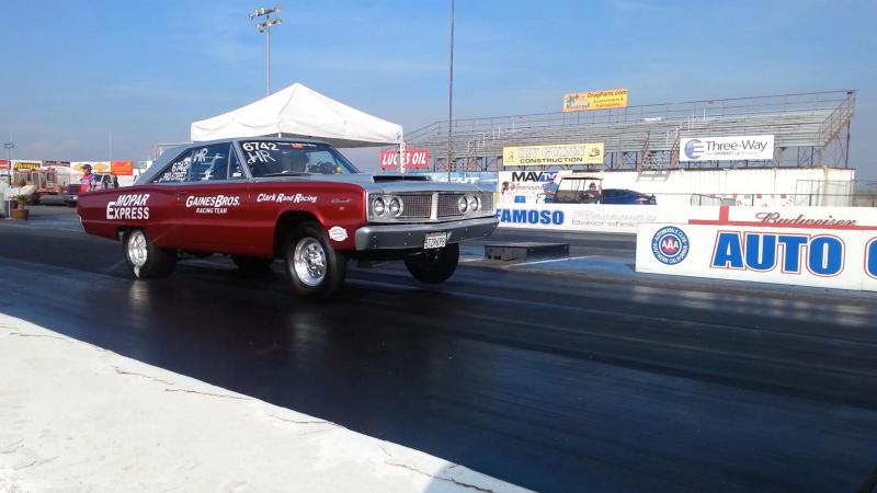

Best Wheels Up.jpgMaybe I should have, but I never worried about my front Torsion bar size.
I use my car primarily for Drag Racing but it is street licensed and insured with Hagerty and I do drive it to the Hot Dog stand and some car shows but mainly drag racing.
I have the following:
Moroso Front Runner Tires
90/10 Cal Trac Front Shocks
Complete Cal Trac Rear Setup...Cal Trac Bars/Cal Trac Mono Leaf Springs/Cal Trac 9 way Adj RR shocks.
MT 28x13.50x15 M/T DOT Bias Ply Street Slicks (11.25" tread width)
Cal Trac told me to make the "traction system" all come together that I needed 2 things setup correctly with all my parts:
1) With the rear shocks not yet installed on the car 2 guys ought to be able to push up and down on the rear bumper and almost be able to "bounce" the car like a basketball, meaning the shackles had to NOT be binding.
2) I needed a minimum of 5" front wheel travel (measured by putting a yardstick up next to the front fender lip and then jacking the car up on the k-member and having the front end "lift" 5" before the front tire came off the ground.
I did this by rebuilding my front end with all new parts and then actually "loosening" the torsion bars so the car actually sagged down about as far as it would go and still not rub the front tires when turning. (You can see the front end travel in the picture of the car launching off the line)
I DID ALL OF THE ABOVE...and first outing when I launched the car off the starting line it pulled BOTH front tires about 6" off the ground for about 10 feet...and this is with only a 505" with only 600HP...not a real monster motor. It does 1.55 60 foot times right now. I hope to get it into the mid 1.40's with my new Edelbrock Single Plane Victor 440 and new 1050 Dominator and lots more tuning in re: to jetting/timing/launch RPM and RR Tire Pressure.
I rides kinda crappy on the street but I dont really care. It does what I want...which is to GET TRACTION.
All this is for your consideration when putting your suspension together.
