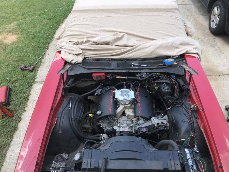

I'm not a hater of Holley Snipers by any means. I have installed at least 6 of them on various engines and types... There were only 3 issues on all 6 installs. One was the 02 sensor went bad. And another o2 sensor went bad on a different car. And this latest debacle with the bad ECU. So mostly just odd issues. I replaced the Holley 02 with a Bosch 02 sensor and no issues since.
Update to my original post: JJ took the GTX to the local MLK day parade and ran the 45 minute route with no further issues. So either the software update fixed it of whatever weird *** bug worked itself out. He said it ran great.
LS 5.7

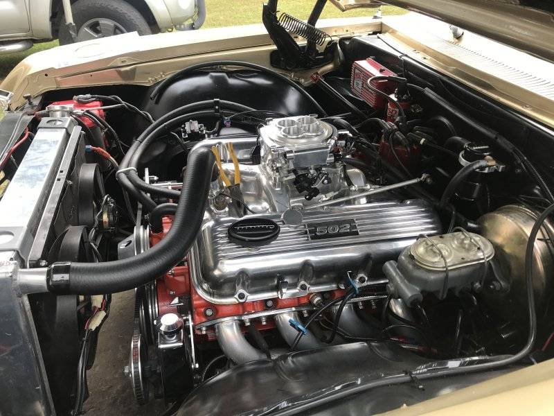

502 big block chevy
