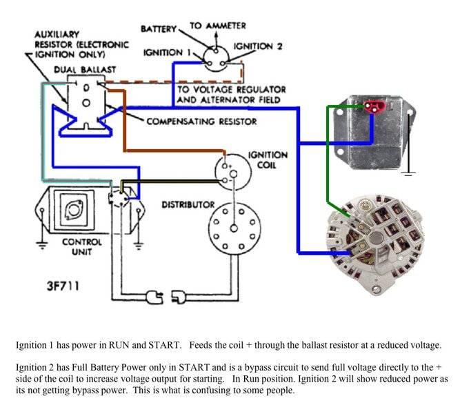

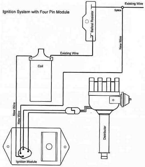

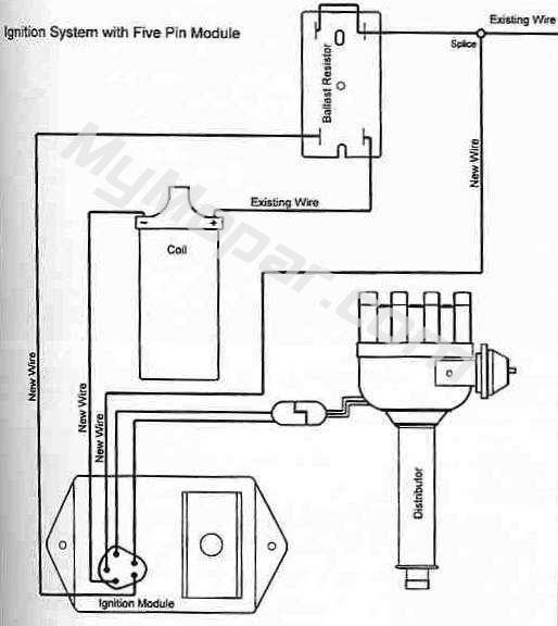

this is a basic diagram
IMO this is the best, 73 & later style
for the stock-ish to mild performance ignition
the Chrome Box is better
then the orange boxes,
unless you can find or have an old org. Direct Connection era boxes
then the orange boxes are pretty damn good
but DC Chrome Box is even better, more spark dwells, more RPM range etc.
the Gold box is race box only
Chrysler Electronic Ignition Wire Diagram 4 pin Ballast & Electronic Volt. Regulator.jpg
