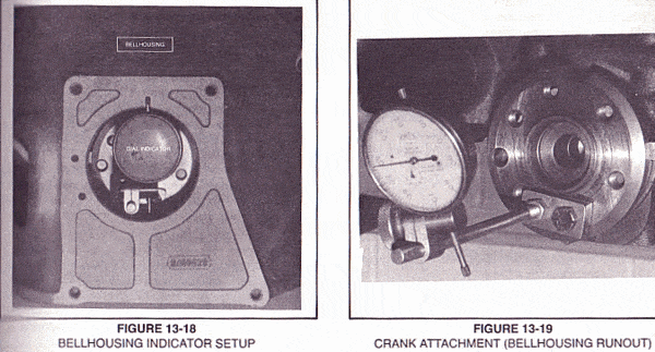

This is covered in the SMs. Setup example picture from the MP book........
