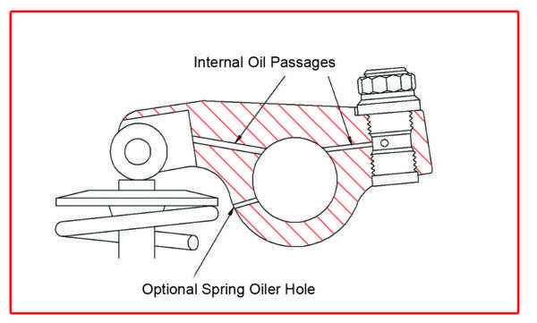

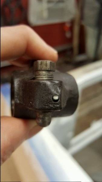

I got t&d rockers that have internal oil passages so if they’re not set up right no oil, maybe look into it if yours had a similar set up
Because of the way Mopars are fed threw the shafts they aren't going to throw oil all over the place like the crappy Chevy setup. I think if you didn't have solid pushrods you'd see more oil upstairs?
The Crane rocker has these passages. I used a piece of red wire to show the routing.
(Actually the top two are Elgin rockers but are ported the same.)
And the hole on top
