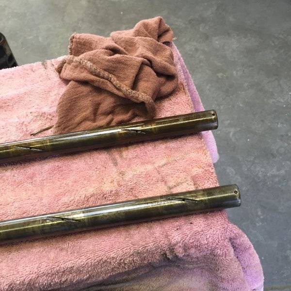

The rocker shafts, while possible to install with the holes incorrect, it won't necessarily stop oil flow (with stock rockers). As long as the end plugs are installed properly, and the cam bearings installed correctly, it should oil. Now, with aftermarket rockers, as previously shown, might not oil properly due to a hole alignment mismatch. The original rockers have a channel in the middle of the rocker, and the aftermarket ones don't. As mentioned previously, shafts that have the diagonal grooves is what you need to fix this. If you look at early and late hemi rocker shafts, there is a groove for proper oiling, and this is what you are missing as OE wedge shafts only have a hole. The grooves help the additional hole get oil.
View attachment 563673 View attachment 563674
I'm thinking this is the problem, not having a groove through the oiling hole in the shaft. The Crane rocker has a groove in the center, going around inside but the oil passage for the top hole is offset from that (towards the outside of the rocker). So there is not a good way for the oil to get out there without a groove in the shaft. There is some oil getting there but I'd like to see more.
I thought about making a groove at each hole, but I didn't read or hear anything about this being mandatory. It makes more sense now that they are necessary for better oiling.

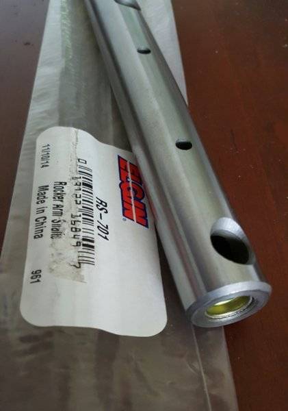

These are the shafts that I installed.

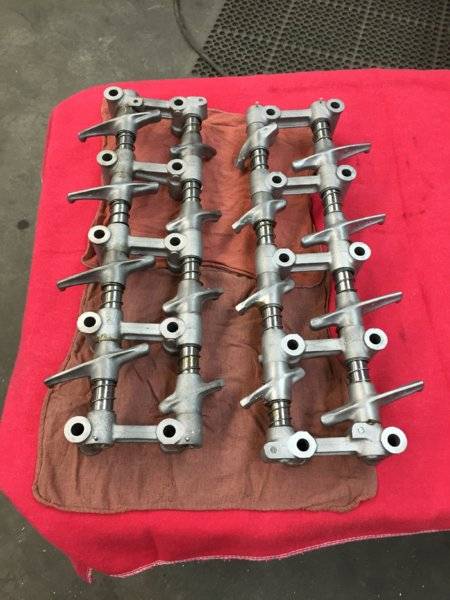

Here’s Andy’s 470 with t&d rockers, also had a dry sump
Here’s some crane rockers on a small block, crappy video but you can see the oil slinging around
Some t&d rockers, look to be the same as mine
We're getting into some high hp, external oiling, ect. engines here. I'm basically stock except for the hv pump. I'd like to see that kind of oiling up top but I don't think it's going to happen. I think 69Bee is onto something with not having the grooves in the shaft.
Exactly what I did and it fixed the issue. Recheck everything while you have it apart.

Im running 440Source rocker shafts with Erson ductile rockers and the shafts have the oiling holes drilled through on shafts, 2 holes. I have about the same amount of oil as the OP, also using an HV pump. the only thing I may do is put a banana groove on each oiling hole, but otherwise its just fine.
You stated two holes in the shaft, two at each rocker location? I only have one at the bottom, just like the stock ones.
