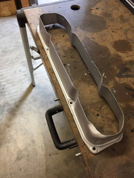

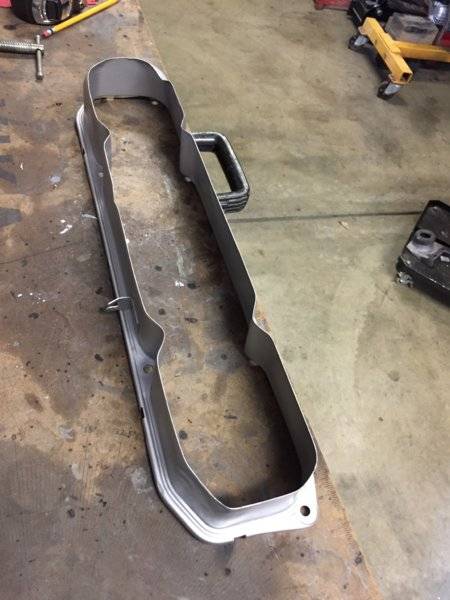

I took an old valve cover and cut the top of it off, cleaned, blasted and painted it so I can see exactly how much oil is coming from the rockers. I’ll take a video and send to 1967coronet440 so he can post it.

Hell, I was curious too! And I had a single ratty valve cover collecting dust.
Thanks for posting the video!!
you should be able to see oil running out of the top and back holes.
