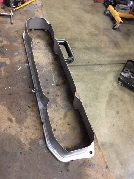

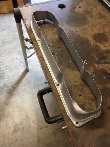

I took an old valve cover and cut the top of it off, cleaned, blasted and painted it so I can see exactly how much oil is coming from the rockers. I’ll take a video and send to 1967coronet440 so he can post it.
B6CAD563-9EEB-4AF0-BCF7-7112BE44B25D.jpeg D3A7EF12-904C-467A-807D-A5AD0CB9BE4B.jpeg
I showed the video of mine to my local engine builder, Tim and he said absolutely nothing wrong with mine. I’ve been waiting for him to get back from the National Roadster Show to have him look at this. Now he’s been building engines for 45+ years, so I’m gonna take his word. I can still check for you guys, just need to get a valve cover gasket. Let me know if it’s still needed to be done.
