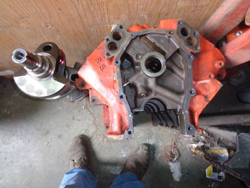

Bore is just .030 over stock. Mahle pistons. 4.25 Molnar crank with BBC 2.20 rod journals. Molnar 7.1" long rods. 505"

@biomedtechguy , like that girdle main cap system . i'm doing an iron block with thick cylinder walls , 4.5 bryant crank . turning it down it bbc rod ends , keeping the bore as small as we can , min of 4.4 . its 4.38 now . its tobe street strip car . i've got stage 6 mw alloy heads fully pro ported , do i need a better head ? i think that girdle setup would hold it together better that what i've got info on . do we get any cost breaks . i never hear of anyone running carrillo rods any more , any reason ? going with racetec piston . my cam guy has a special grind for my build .

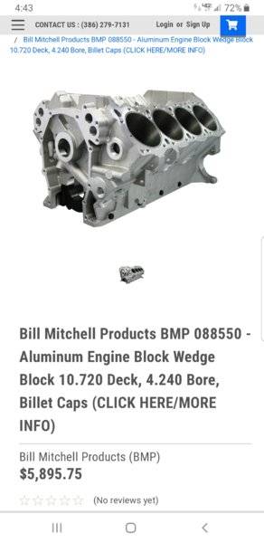

Bill Mitchell is offering this according to their website:
Bulldog still doesn't show a price on their online cost sheet for the aluminum block "available late 2018"
Is that the Bulldog now?
I'm serious about this, so any details about who offers aluminum blocks for wedge builds is appreciated.
